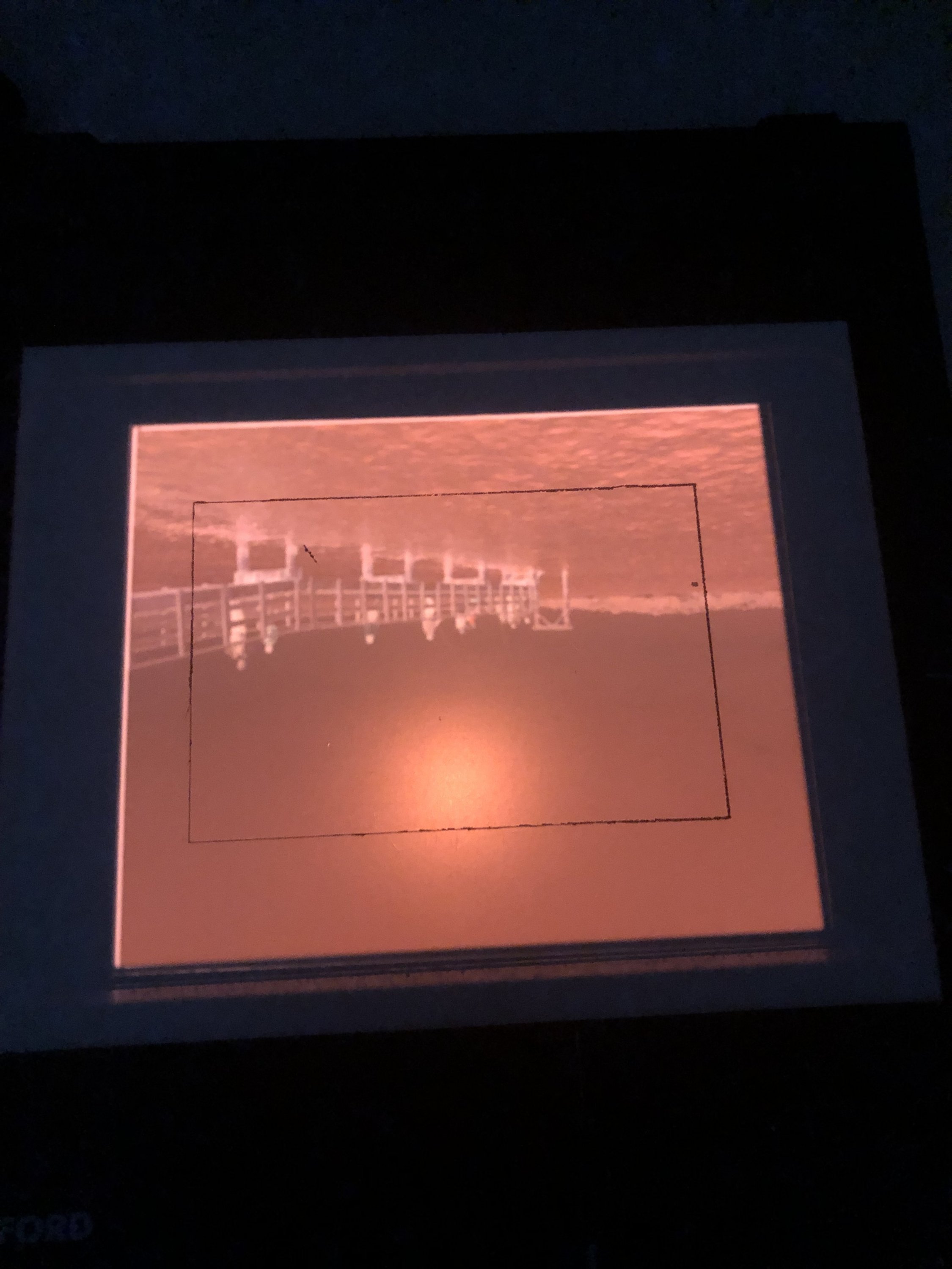

Hi Everyone, Thanks for your replies. I will run some tests like Nicholas says and see what happens. Attached is a photo of when I enlarger my 6 x 7 neg onto my 8 x 10 paper. I have noticed that there are these bars of light on the top and bottom and they are coming from the carrier. Do you guys think that could be causing it?

That attached photo(post 17) shows a lot of clear edge along two edges of the neg in the carrier...creating flare internal to the optical system, on top of any light that is escaping the enlarger that bounces off light colors adjacent surfaces in the darkroom area.
