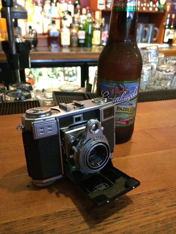

It looks like you have a nice camera there.
But to weigh in on the original question, I have a Vito II and a Retina 1b. They are both nice, but the Vito is truly a work of art. Much smaller and sleeker than the Retina, it exudes quality and craftsmanship. Folks will look at you funny no matter which one you use.
