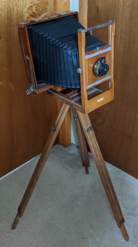

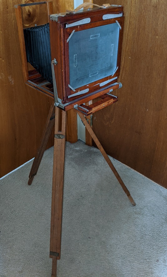

I bought my first 8x10 camera last weekend and it looks beautiful. The bellows doesn't look bad but unfortunately I discovered, after testing with a led light in the closet, that its peppered with pin holes. Apparently it belonged to a photography studio in a town in the next state and I suspect they had it out in the open, extended for display for many years. I would like to replace the bellows..... Anyone had a bellows replaced? I'm wondering what my options are..
