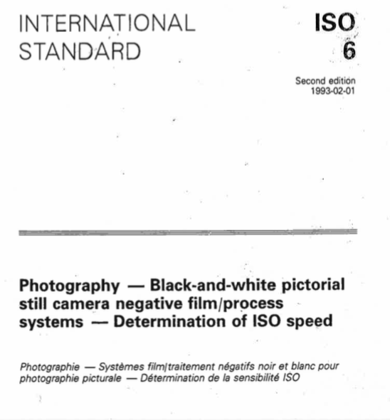

Look up ISO film speed and you will have the answer.
The only variability to ISO speed that I know is that you are allowed to change the developer... So if you can formulate a developer that hits 0.1 over B+F with less light hitting the film and you can still hit the other parameters, you have raised its ISO speed.
You might be able to pull a stunt like discover the best keeping temperature to preserve maximum latent image during the holding period between exposure and development. I'm not sure the holding temperature is specified, near absolute zero might retain latent images better. This might raise its ISO speed.
But basically, a film's characteristic curve dives down to zero net density above Base + Fog at a certain exposure and you can't move that much to the left.
To get 0.1 over B+F with less light, you increase silver laydown when coating. Of course, this will effectively have two possible effects. One is to sharpen the toe (see above) or the other is to move the inflection point of the curve, but this is somewhat less likely.
PE
I guess you could say there is only one ISO speed per film / developer combination. Each film could have a dozen ISO speeds if the film manufacturers wanted to do all the necessary testing. But for any one film /developer combination, there is only one ISO speed. The ISO B&W film speed standards has strict parameters that must be followed, Including contrast parameters. If the testing is outside of the conditions stated in the standard, ISO cannot be used as the prefix. Instead EI should be used. Film speed will change based on degree of development, but not as much as most people believe. The reason for this is due to the method of speed determination. When properly determined, film speed changes little with decreased and increased development outside the ISO standard's specified contrast.
