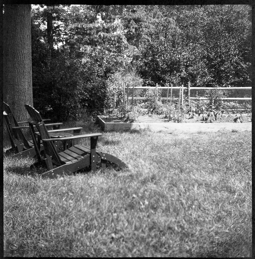

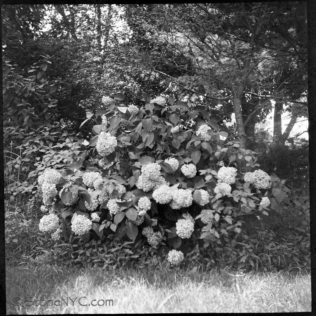

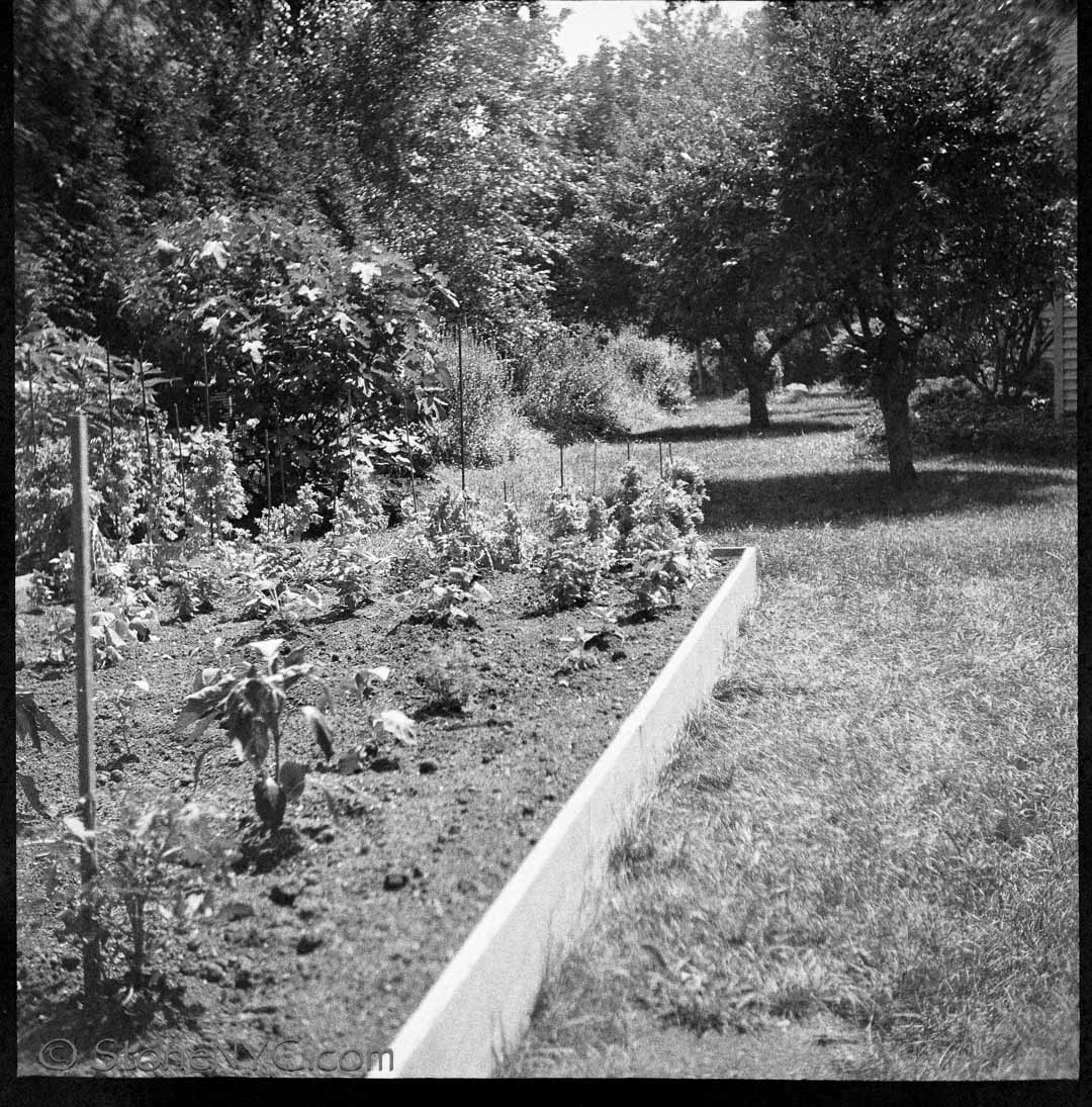

OK without further ado...
As you can see, only the bottom portion of the image is out of focus, but yet on the outer edges of the same area it's more in focus. I just want to clarify if you think this is DEFINITELY film plane error, or if it COULD be something wrong with the lens/lens plate.
The "old" NON-LM version had a problem where the "lensboard' plate that held the lens was bent out, and usually one corner of the image was out of focus, but if it was an infinity shot, I could press really hard against the plate and basically get it all in focus ok... so I was hoping this yashika44(LM) was in working condition. Now I've only run one roll of film through it, but it was a roll of VerichromePan that expired in 1966, it seemed fairly curly and seemed thick at the time, but now that I've processed it, the curl kind of lessened a lot, but I'm thinking the curl was too much for the pressure plate, but I only have one "good" roll of Efke100 that's new stock left, everything else is old, a few Kodacolor-X and one more VP127 from 1968. I bought into the Ilford ULF for 46mm film, so I'll re-roll that using the old backing paper, so I'd rather have this stuff work right now so I don't have to worry about the HP5+ re-rolled 127 to have any issues. So should I risk trying to adjust the plate or should I hope that the HP5+ won't have this issue?
The yashika44LM has a roller at the bottom that supposedly is there to guide the film and keep it from curling until after it's outside of the exposure area. Also, I feel stupid asking but, when light hits the film coming out of the lens, is it upside down? this would mean that the trouble area is the TOP of the film coming from the top spool, but that seems pretty flat, but what do I know...
END OF BABBLE, HELP!

Stone:
It is really hard to tell from your examples, because the lack of focus could be due to depth of field issues rather than film flatness issues. Do you have any examples where you have photographed something like a flat wall?
And you are correct - the image is upside down when it reaches the film.
Is there any chance that the back isn't sitting flat?

Back is flat, and I don't have a flat wall, but it's not DOF because if you look at the edges, especially the first image, the edge of the image is clear within the same plane as the blurry center. That's why I suspect it's film curl and not the lens, but I'm no lens expert...
My other question would be, if it is film curl, is this just happening with old film and new film will lay flat? Or will it continue to be an issue with all film...
The back LOOKS like it has two screws, but I don't want to mess it up and scratch the film either with too much pressure...

Just a suggestion...
Is there some kind of spring or rider that should keep tension on the film roll? It could be a case of the film unwinding a bit and allowing a bulge off the film plane. Maybe something is missing or out of shape? Some people put folded cardboard or a slice of foam in their Holgas to combat this.
Edit: the camera on the left above seems to have something and the camera on the right might be missing it.
