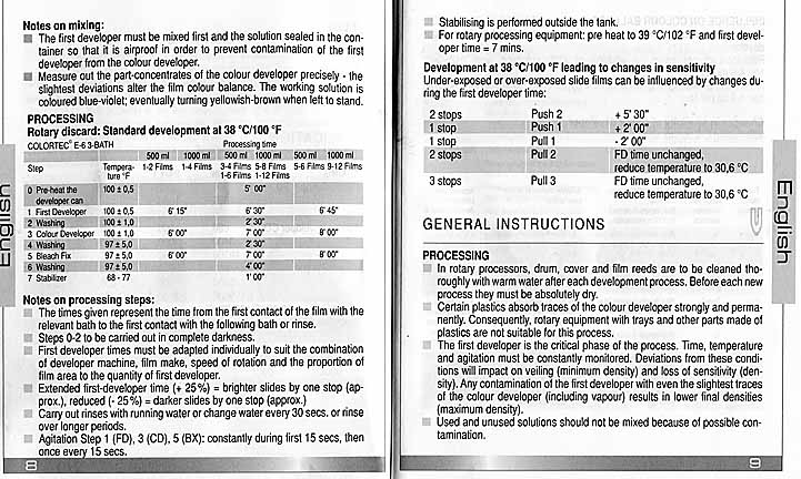

I have just had a new 1ltr Tetenal E6 kit delivered and I am somewhat confused by the instructions. They seem to contradict each other at opposite ends of the instruction pages. The last lot of E6 I used was also Tetenal and the instructions booklet from that lot shows they are different. Are they covering themselves just in case something goes wrong?
In the new booklet The instructions are shown on page 8 for 'Rotary Discard' which I always use.They give the pre heat time as 5 mins and the 1st development time as 6mins 15 secs, which is the same as in the older booklet. As are the remaining steps shown on page 8.
However in the section Notes on processing steps right at the bottom it suggests to me that the agitation should be constant for the 1st 15 seconds, then once every 15 seconds. That to me doesn't sound at all like rotary processing but they don't say so. Then on page 9 there is a bit about stabilising and below that a line which reads :-" For Rotary processing equipment, pre heat to 39C/102F and first development time +7 mins"
Has something been lost in the translation or am I simply being a little bit slow? What time should the 1st development be 6'.15" or 7 Mins and is it rotary or inversion agitation?
Below that is a section about general instructions and the 2nd paragraph contains something I have never come across before, about plastics absorbing the 2nd developer and should not be used!!! I only know of rotary processors that use a plastic tank and the measures are plastic so what should be done? A scan of the two pages is attached.

Rotary is always constant agitation.
That would seem obvious, but they don't make it clear. they give 2 processing times for the 1st development 6.15 mins/secs and another for 7 mins using rotary method and then refer to agitation at the start which is clearly inversion agitation. They are not very good. I could use the old set of instructions which ar clear precise and easily understood, but I don't know if they have changed the formula also they have included sections in the new instructions about contamination of plastic tanks by the colour developer, this was not there before.

I can only sympathise. I have never heard of an inversion system requiring less time nor of plastic tanks giving contamination. Given how much Jobo tanks are used for colour work there may be a lawsuit from Jobo on its way as we speak :D
Unless Tetenal address these issues which might simply be careless translation or lazy text composition then assuming there are alternatives to Tetenal E6 chems it might find its sales dropping off
In the U.K. there are several retailers who are switched on such as Ag Photographic, Silverprint, Process Supplies, Firstcall and RKPhotographic. Raise it with one of them which supplies the kit.

I can confirm that the translation is not the problem. The German instructions have the same inconsistencies.

Seemingly when giving the manuals a new lay-out they messed things up.
NO!
The English text has as header:
Processing - Rotary Discard
The German text:
Processing - Inverting- and Rotary-processing
Thus with that header in mind the reference to different dynamics of inversion makes sense!
The French, Spanish, Italian, Dutch and Danish versions all follow the German one.
Obviously the error (omission) is only in the English translation.
Hopefully the mistakes have been pointed out to Tetenal and new instructions are in the latest kits.
Not Likely: the manual with the erroneous English text is still at their website.

Assuming the OP is looking for clarification rather than simply pointing out the confusion Tetenal that the English translation/ text transformation has resulted in, can I ask that you clarify what it should say in English. I know from our correspondence that your grasp of English is superb. It would help me as well

Agitation
As the error on the agitation issue consists of omitting only one word, "Inverting", I thought the advice would be clear.
My advice is to read the headline of the processing part of the manual as it was written in German.
Thus the following text in the manual is aimed at both, inverting and roating processing. Read it as:
-) In case of inverting processing to invert (turn upside down the tank) for the FD/CD/BL steps continuously for the first 15sec, then invert just once every 15sec
-) in case of rotating processing: forget about the sentence above...

OK. Forgive me if I am confused. So are you asking what the proper agitation method is for rotary processing?
It isn't listed in the notes because rotary processing doesn't require user input. Just an increase of time and temperature. Which are part of the same notes that continue on page 9.

Wayne, yes, you got it wrong: I'm not asking about any agitation method. It was the OP.
Temperature and time
And Tetenal does not advise to rise the processing temperature, but to pre-heat at 39°C.
Which would mean to heat it seperately and then at the start of processing insert it into the 38°C machine.
Which does not make sense (to me). Especially as in the C-41 manual they advise to pre-heat at 38°, which just means rotating the tank for some minutes "idle" before starting the process. And in the C-41 manual there is no reference to inverting processing.
That 39°C and the prolonged time for rotating in the E-6 manual would rather make sense for inverting the tank outside a warming bath: using higher process temp. and longer time to counteract cooling of the drum.
As I said they made a mess out of that manual.

Your reply even confused me more, especially on those rotation speed settings. Thus the Tetenal manual above is even more questionable.

The problem continues! I have had a long almost meaningless conversation with the Tetenal Company in UK who at first did not appear to want to discuss the problem and it wasn't until I mentioned that I would get in touch with the parent company in Germany and complain, that someone actually phoned back and spoke to me. Basically,They could not explain the difference between the two temperatures mentioned (38 +39 degrees C) and the different times. They actually stated the longer times were due to the higher temperatures. That is a stupid uninformed remark! Nor could they explain why, what appears to be inversion agitation is included in the ones for rotary agitation without giving an adequate explanation
The guy supposedly from the technical department actually suggested that I carry out tests myself to find out what is the correct times to use.... Errrrr ....... no... they are supposed to do that before they market the item!
They are now getting in touch with Tetenal in Germany to get the correct answer.
I will never use Tetenal again if this is their degree of customer support.

Nor could they explain why, what appears to be inversion agitation is included in the ones for rotary agitation without giving an adequate explanation.
At least this problem is solved, as I explained above, hinting at the omission of the word "inverting" in the English section.
The other issues of course are not solved...

I got fed up with waiting for a reply from Tetenal so I made a decision and went ahead using the JOBO timings which seemed to be the most straight forward, but with fingers crossed! Well they are perfect even if I say so myself. 2 lots of transparencies hanging up to dry. 1 x Fuji Sensia and 1 x CR200 which I believe is a re-hash of an Agfa film, but made in Belgium.
I modified the timings slightly, from the JOBO recommendations. I Washed between stages longer than the JOBO = 5 x 30 second instead of 4. and colour developed for 6 mins instead of 4. Otherwise it was as per the JOBO times Both films were as good as I have ever done in the past. That is what I will use from now on.

pentaxuser. No problem with the tanks as you surmised. I think these 'warnings' are given out as a possible defence against being sued if things go wrong. But the use of 'plastic is so vague and no plastic is specifically highlighted that use as a defence would not really be adequate. I have no proof of course but you get used to reading between the lines in this day and age.
