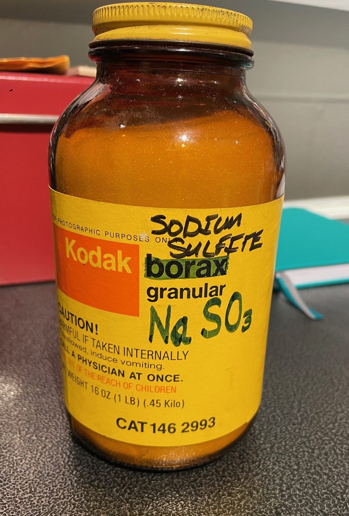

Along those lines, would you trust this bottle I picked up with some darkroom equipment?
CAS number is not quite right...
(and yes I do understand it is not Sodium Bisulfite... maybe)
I see a CAT no, not a CAS no. The former stands for 'catalog' and is generally company-specific, the latter is the international identifier for chemicals (Chemical Abstracts Service).
Note that the formula given for sulfite is not quite right - should be Na2SO3. Not that it matters much.
I'd expect the bottle contains sodium sulfite. The contents seem consistent with this - then again, there's lots of granulates that look like this, but given the context, sodium sulfite is a very likely candidate.
Sulfite has a very specific smell in solution with water - you can't go wrong :smile:
I was speaking of the number written in green; I am very familiar with Kodak CAT #s.
The missing "2" in the CAS number for Sodium Sulfite was what was concerning me, but if you look at the "a", it almost appears as if they overwrote the "a" with a "2".
I agree, it's most likely Sodium Sulfiite, but it did give me pause.
Oh yeah. Good idea. I have some known Sulfite so can do a comparison "sniff" test with a bit mixed up in water.
Thanks!
Ah, I see; that's the chemical formula. CAS numbers are digits only; the CAS no. for sodium sulfite is 7757-83-7.
I'm not too concerned about the missing '2' - think about it. NaSO3 doesn't work out if you take the valency of the ions into account: SO3 has a valence of 2-, and Na has a valence of 1+, so there must be two Na's to every NaSO3 for the salt to be stable. And since it's present as a crystalline substance (i.e. quite stable indeed - the bottle isn't filled with a hot plasma), there's little room for doubt what happened. Besides, they labeled the bottle with 'sodium sulfite' and correctly included the sulfite ion in the chemical formula.
Now, if I were to proceed with the hermeneutical analysis on this one, the only puzzling thing is the space they left between Na and SO3. Now, that one's a riddle for sure - did they doubt about the formula and anticipated adding the '2' later on, but somehow got interrupted while looking it up? Or did they have in mind to add a 'H' in order to really throw you a curve ball, as this would make it a bottle of...bisulfite. But then, we know that solid bisulfite doesn't really exist, so the plot would thicken at this point to a veritable riddle wrapped in a mystery...ah well.
It is a pretty bottle - have I mentioned that?
Guess it's pretty obvious I don't know a valance from a valise, but thanks for the effort!
I have several pounds more of properly labeled Sodium Sulfite, so bottle this may just remain a pretty face...
