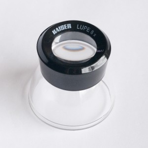

I used this loupe:
KAISER 2334 8X LOUPE STAND LUPE MAGNIFIER SLIDES FILM VIEWING K2334

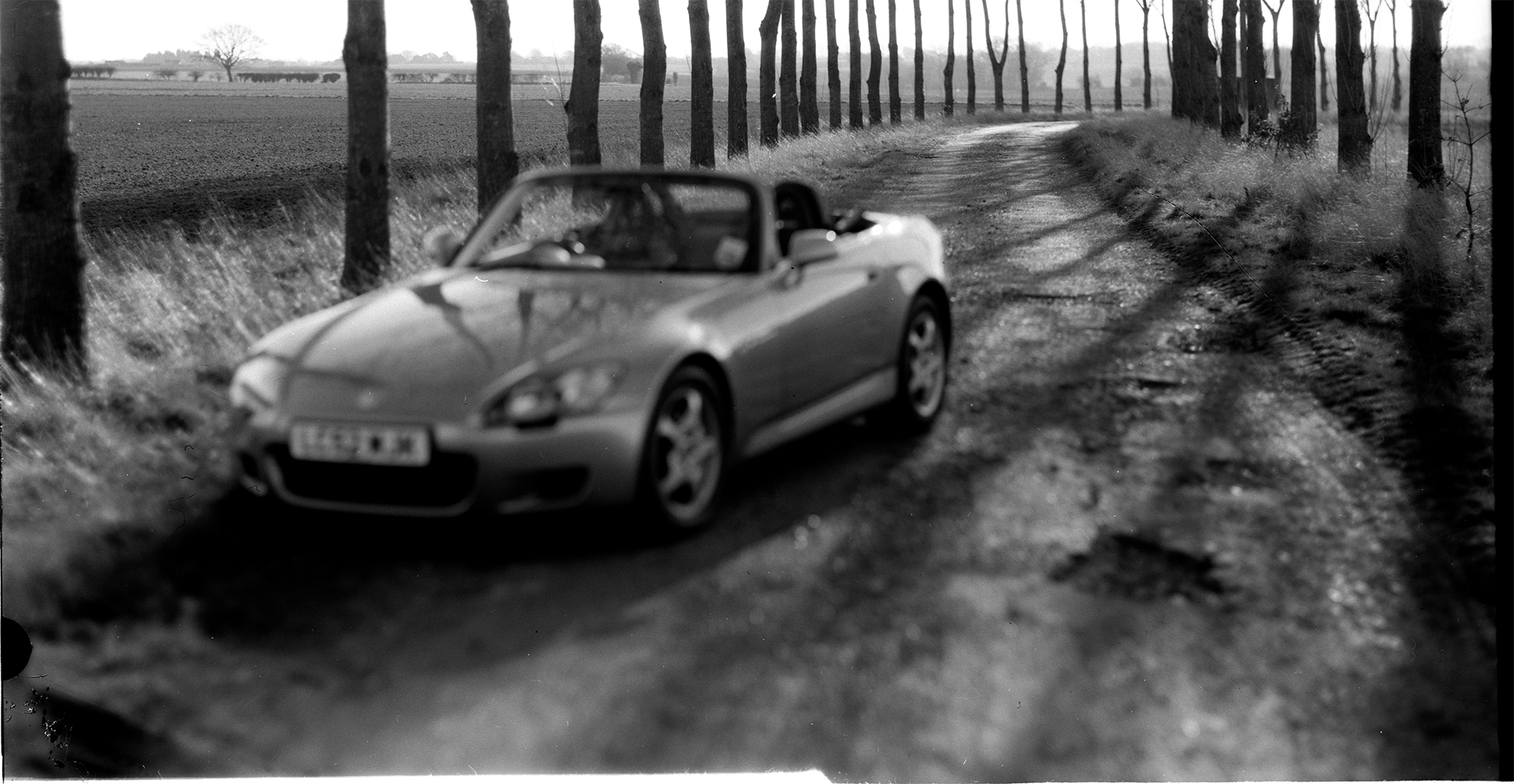

Cheers guys, on the fresnel (ribbed glass?), which way should the ribs be pointing? Untitled_Panorama2.jpg
here I was focusing on the nearest headlight!
