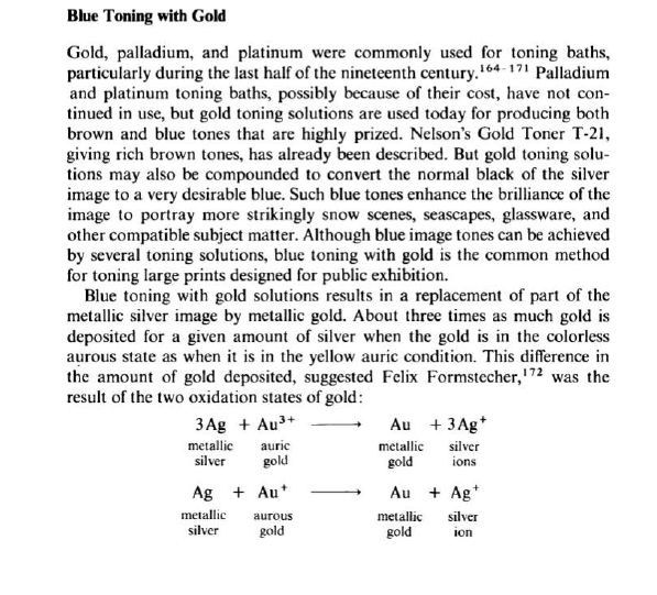

Currently in between darkrooms so I'm doing a lot of reading to study up before I begin constructing my new darkroom. I'm reading a lot about toners, and my question relates to the gold toners. Search results for gold chloride( Au(I)Cl or Au(III)Cl3 ) often bring up results for chloroauric acid (HAuCl4), even on suppliers sites such as ArtCraft chemicals, does this compound work as a gold toner? Though I haven't tested it from what I've read in Modern Photographic Processing(Haist) the gold toning reaction works via free Au ions reacting with metallic silver, where chloroauric acid would dissolve into [AUCl4]- ions. Has anyone tested chloroauric acid, the salt produced by the dissolution of gold metal in aqua regia, in print toning?
My second question is which gold chloride salt is preferred the Au(I) or the Au(III). Haist mentions that the Au3+ would displace 3Ag atoms, requiring less gold so I'm assuming this would be desirable? I'm just confused because the name Gold Chloride seem to be used rather interchangeably.
Screenshot is from Modern Photographic Processing Vol 2 (Haist p122)
Any insight at all into either of these questions would be greatly appreciated :smile:

The Gold chloride sold by ArtCraft is appropriate for Gold toning of prints. I've been buying it from them for years and making my own Gold toner for toning Kallitype and Salt prints.

So I called ArtCraft and he confirmed that it is chloroauric acid not gold chloride. So my next question is why does every formulation list gold chloride as the reagent needed when it is actually chloroauric acid that is used. Additionally if anyone knows the mechanism of this reaction I would love to know.
ArtCraft lists it under both names, undoubtedly speaking to the incorrect naming history (see below). It is what I have been buying for years, to make the gold toner that uses Ammonium thiocyanate as the second component (It's a two stock solution toner, diluted to make a working solution). I've used this for ages to tone Kallitypes and Salt prints. I know that the version ArtCraft sells is perfectly suitable for making a Gold toner.
A quick search gave me this: In solution, chloroauric acid behaves as a source of Au(III), and it is often used in gold plating, nanoparticle synthesis, and photographic processes.
Also: In the photographic literature, HAuCl₄ was frequently called “gold chloride” or “chloride of gold” even though chemically it was the acid, not the neutral chloride (AuCl₃).
So I gather that technical manuals from years ago started calling HAuCl₄ "Gold chloride" when in fact it was not. True Gold chloride isn't nearly as soluble in water, so we use HAuCl₄ for our processes.
