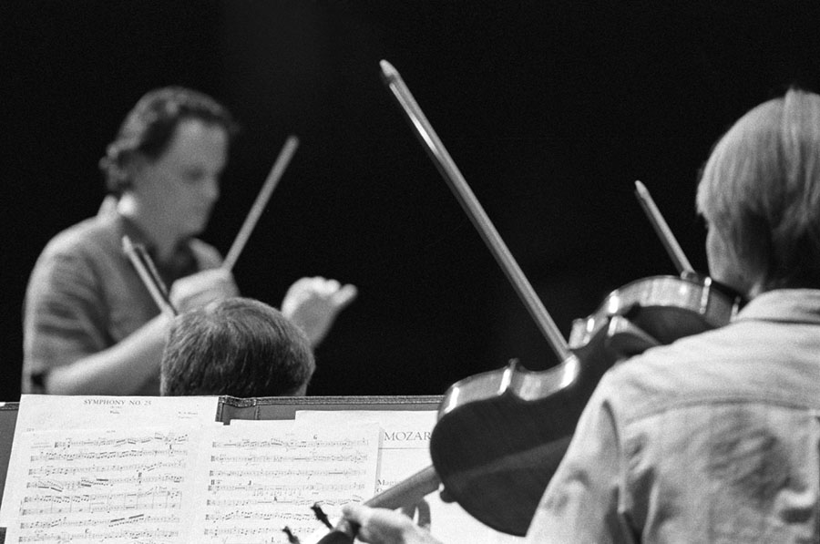

One of my better (and luckier) early pictures was of the high school conductor during a concert. I used bulk P3200 (I miss those days…) at 6400 in Tmax developer, which is what we used to develop everything. The camera was a Pentax PZ1-P with power zoom 80-200 or something like that, not very fast at the long end. I distinctly remember spot metering his face, setting the shutter to something hand-holdable (1/250 maybe) and letting the aperture fall wherever. Worked out great. Today, with a faster prime, I would use whichever 400 speed film you like best at 1600. I personally go for HP5 and Microphen in these situations now.
