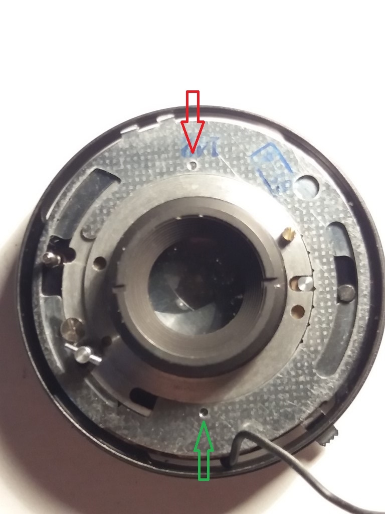

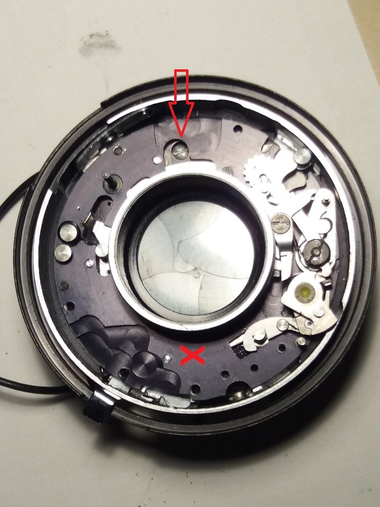

Attempting to repair a Compur SV shutter from a Yashica Campus camera. Have removed the lens and opened the ;shutter mechanisum. The slow speed appears to works, as does the timing escapment, but the actual shutter blades are not moving at all. Wnat to get deeper into the shutter as the ring that opens / closes the blades appears to be locked.
On the back, looking at the aperture ring, there are two small holes that are the end of two screws. If these are released, I assume the rings will come off, allowing access to the shutter blades. By rotating the ring, I can find a screw on the screw access point on the front and when I released this screw, indeed, the aperture ring was loose. But there does not appear to be any access to the other screw. Any advice would be greatly appreciated.
Red arrow show the ends of the screws on the aperture rings to which I have access but the green arrow is the end of the other screw that seems to have no access..
On the inside, the red arrow shows the access hole with one screw lined up and the red X is the approximate location of the other screw but with no obvious access.
Thanks and toodle pip

It's a Copal SV no?
I think you need to toggle the flask sync selector, it'll reveal the screws. There are lots of tutorials online for similar shutters.
You'll also need to remove the pin in the cocking actuator. That requires a custom tool.

Thanks for your reply. Certainly from the back, by moving the flash selector, three screws do become visible but they are not at 120 degrees so not sure. It may be that they hold two parts together but certainly will not allow the rear plate to be removed.
Regarding the 'special tool' to remove the cocking actuator, I guess that is to remove the small T. It can only be a press fit, so perhaps a bit of DIY pressure will do the job. Or a bit of heat with a soldering iron to expand the shaft?
My understanding with further investigation is that once the cocking actuator and the screw in the first photo at the 3 o'clock position are removed, then the plate can be rotate a further 180 degrees to get access to the screw from the same position as is visible in the second photo.
It is all a steep learning curve!!!

I have found that there are in fact four screw around the outer edge that when release, allow the entire shutter and aperture blade assembly to slide out of the main body. All very easy with a big BUT.....!
That little rod for the shutter cocking needs to be removed and it will not budge. I made a tool and all I am managing to do is score the end of the rod. I have heated it directly with a micro flame hoping to expand the shaft sufficiently to tap the rod out, and nothing. I am concerned about bending or snapping the rod but that seems to be the only way to separate everything.
Having release the four perimeter screw, and twiddled with the inner part, the shutter blades and shims have now fallen out. I have dismantled everything and now reassembled (without the shutter blades, timing and self timer) and and surprisingly, the shutter actuating ring now rotates and when cocked by hand, everything appears to be working.
So now I have to get that rod out to reassemble, but how?

Time for an up-date. I did grind a slot into a needle nose pliers but that also proved to be no good. Decided that if I gently hammer the pin, it should come out and if it breaks, I will drill a clearance hole and replace with a pin of the same diameter.
Well, it did finally come out so drilling not required. In separating the shutter from the body, I found that the two screws arrowed in my first post, where accessible as they hold aperture blades in place. Cleaned the shutter and aperture blades; challenging to reassemble and get all the pins correctly installed.
Installed the timer and self timer and the release mechanism and it all works as it should. Then dropped the little cocking pin and cannot find it, so did reduce a pin to the necessary diameter, wedged it in place. In fact, it does not need to be a tight fit (just snug) as the cocking shaft in the camera body, when all fitted together, encloses the pin and prevents it from falling out.
Camera reassembled, leatherette stuck with a smear of PVA and all working like ti just came from the factory.
A challenging and interesting learning experience, now hungry for another camera; I have three SLR from eBay and a Zorki so plenty to keep me amused.
Very grateful for the advice and assistance.
