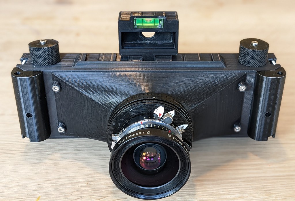

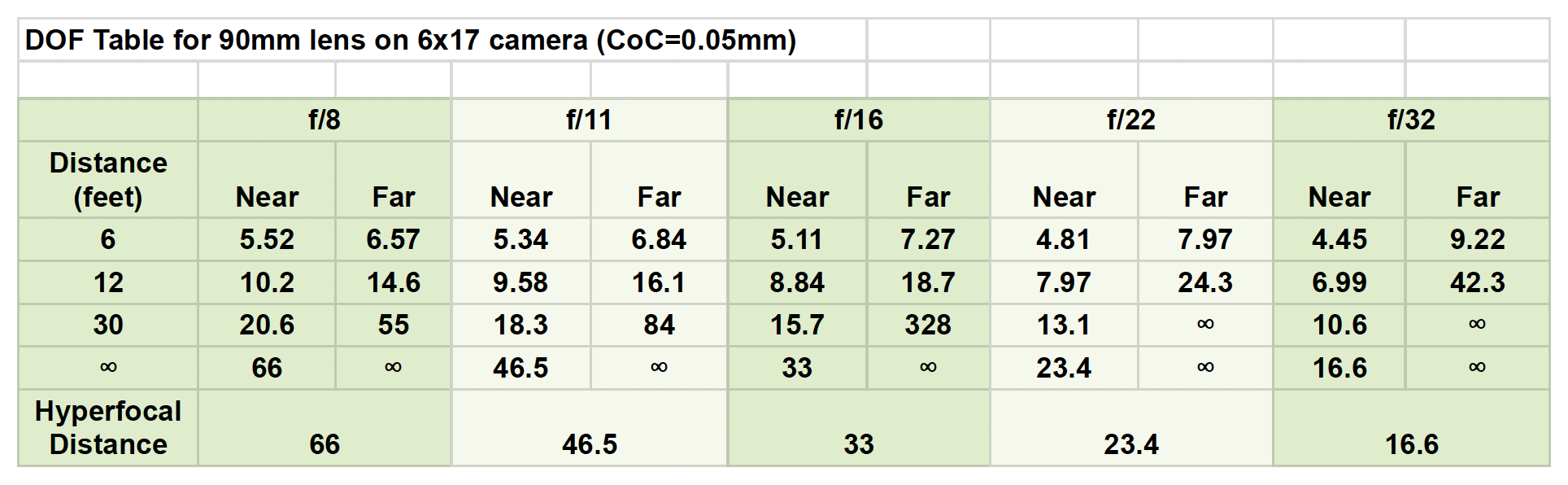

I have a similar setup, Kraken 617 with 90/8 Fujinon lens, albeit with focusing helicoid. With large format, it is better to have a bit of focus control since the DoF is not that forgiving. And those M65 focus helicoid is easy to buy.
Kraken 617 panoramic camera - front view by Zheng, on Flickr
And here is the DoF table I stick to the back of my camera:

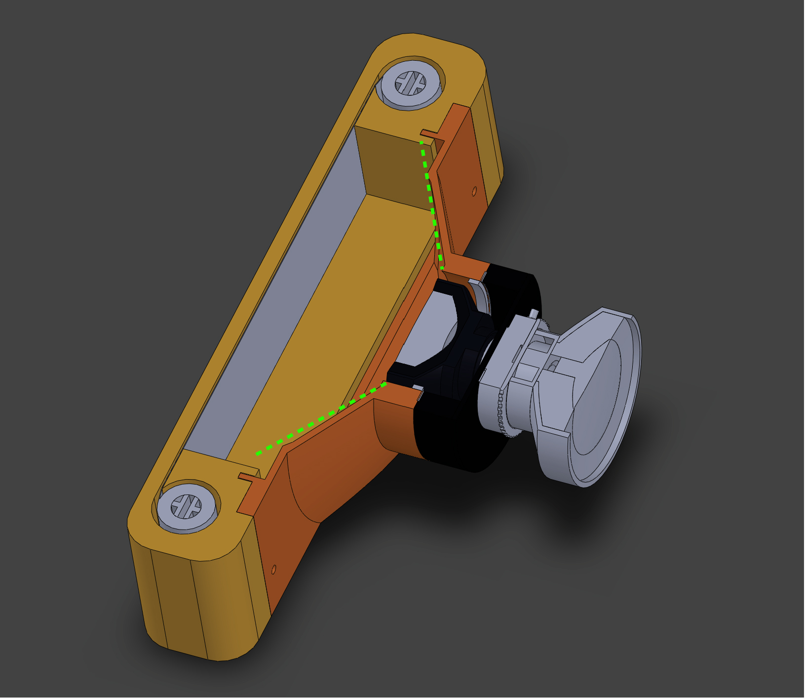

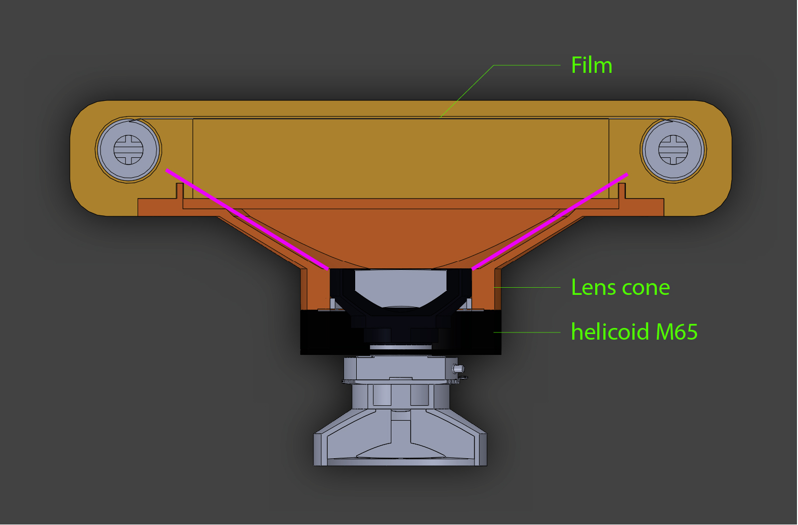

Hello Guys, questions here about the cone, I reduced the size of the cone, but I'm not sure if this design criteria it is ok?
