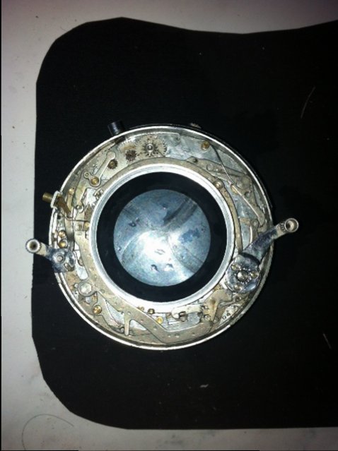

so i open the upper part and got to this view

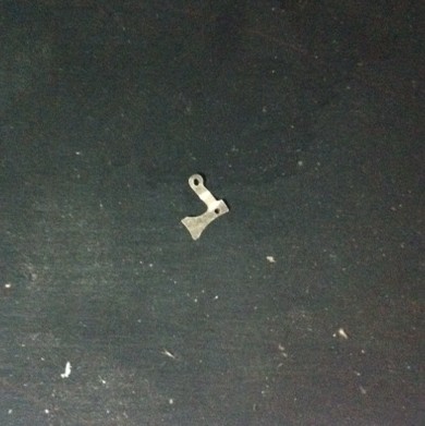

then i open the plate thst covers the gears etc, and fire the shutter, alas this thing jumps out

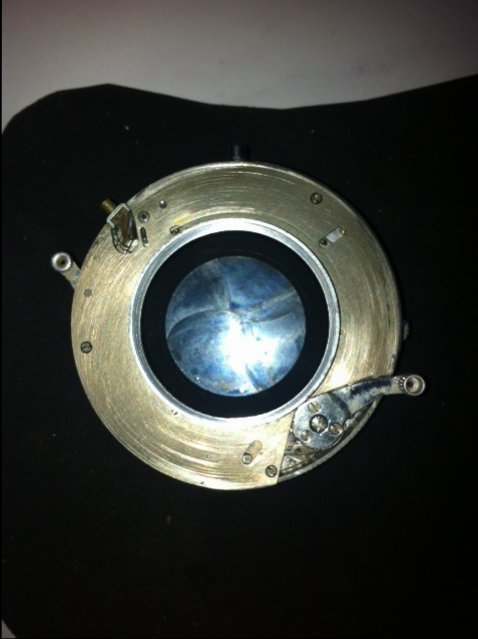

this is the condition right now
i dont know where it came from and its function, so if anyone here is experienced o this shutters could point me where to put it?

I'm thinking that piece is a bridge that locates the pivots of the gears visible at 8 to 9 o'clock.
Well, if you'll notice, the holes for the pivots are two different sizes. So there are only two possible orientations. The real question is: why is it loose?
