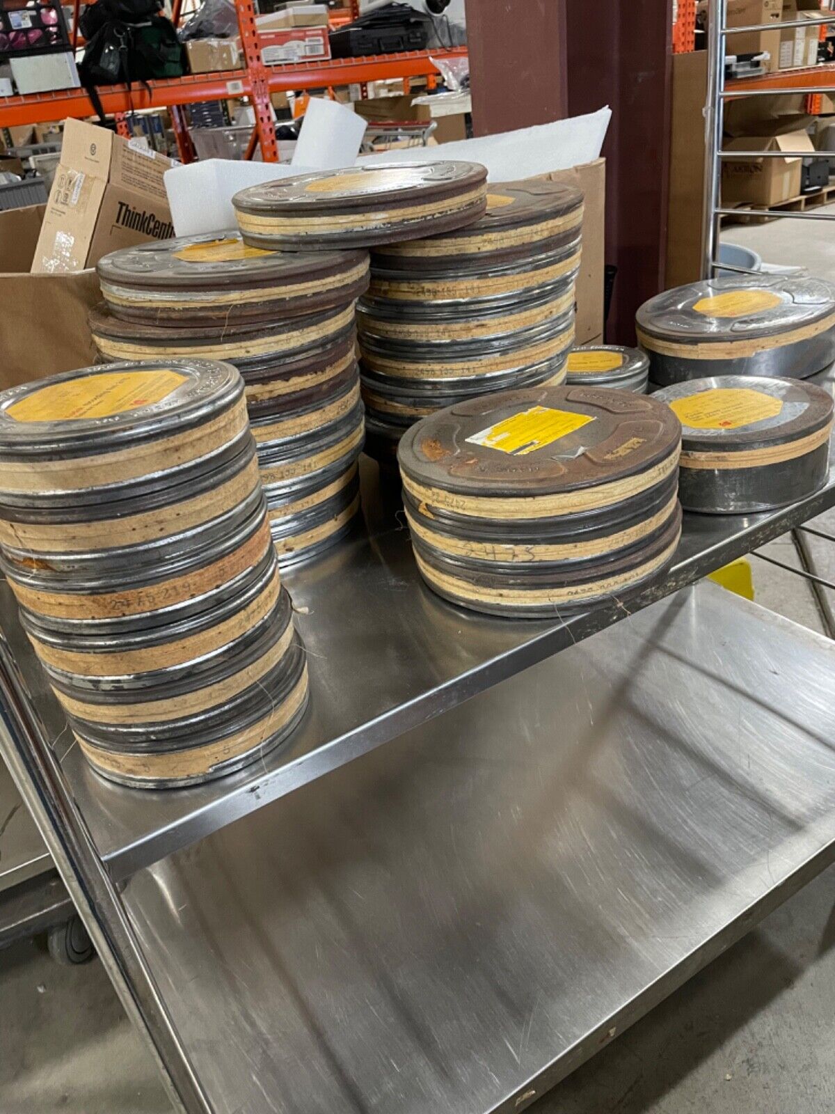

Picture of a big stack of recently acquired 2498 Kodak RAR stock expired June 1981, and some 2475 Kodak Recording Film expired December 1979... from the near-opaque fog level it's apparently been baking in some forlorn military warehouse for most of the time since then.

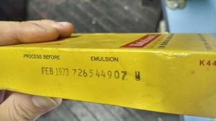

Well, while I still don't have much of the above list, I was able to acquire some of the PMT as Bellini Anti-Fog. Not-entirely-objectively from my first tests, I think it works really well and synergistically with benzotriazole. Attempting to dial in an anti-fog / exposure / development regimen for the stock below got a lot easier with the Bellini addition. This is my first time using PMT.
Here's a successful development from today. Kodachrome II in 16mm, expired Feb 1973, rated at ISO .2
(yes, that's 2 1/3 stops below ISO 1)
Developed 4min @ 74.5F reversal as follows, in a heavy anti-fog developer:
2L D19 pH 10.4 + the following:
5g/L ammonium thiocyanate
90mL/L Potassium bromide 10%
180mL/L Benzotriazole 1%
20mL/L Bellini anti-fog
.5 gram/L extra hydroquinone (an old thread by David Lyga was helpful on this addition counteracting the contrast loss)
5mL/L potassium iodide .1%
Remjet was removed before development. Bleach was potassium dichromate, 2nd dev was plain D19.
Without the above anti-fog addition, a clip test of this film would go opaque black in about 30 seconds in total darkness.
I'd like to continue my comparison with more controlled examples. If anyone has any Kodak Anti-Fog #2, #5, #6, or #9, please message me.
