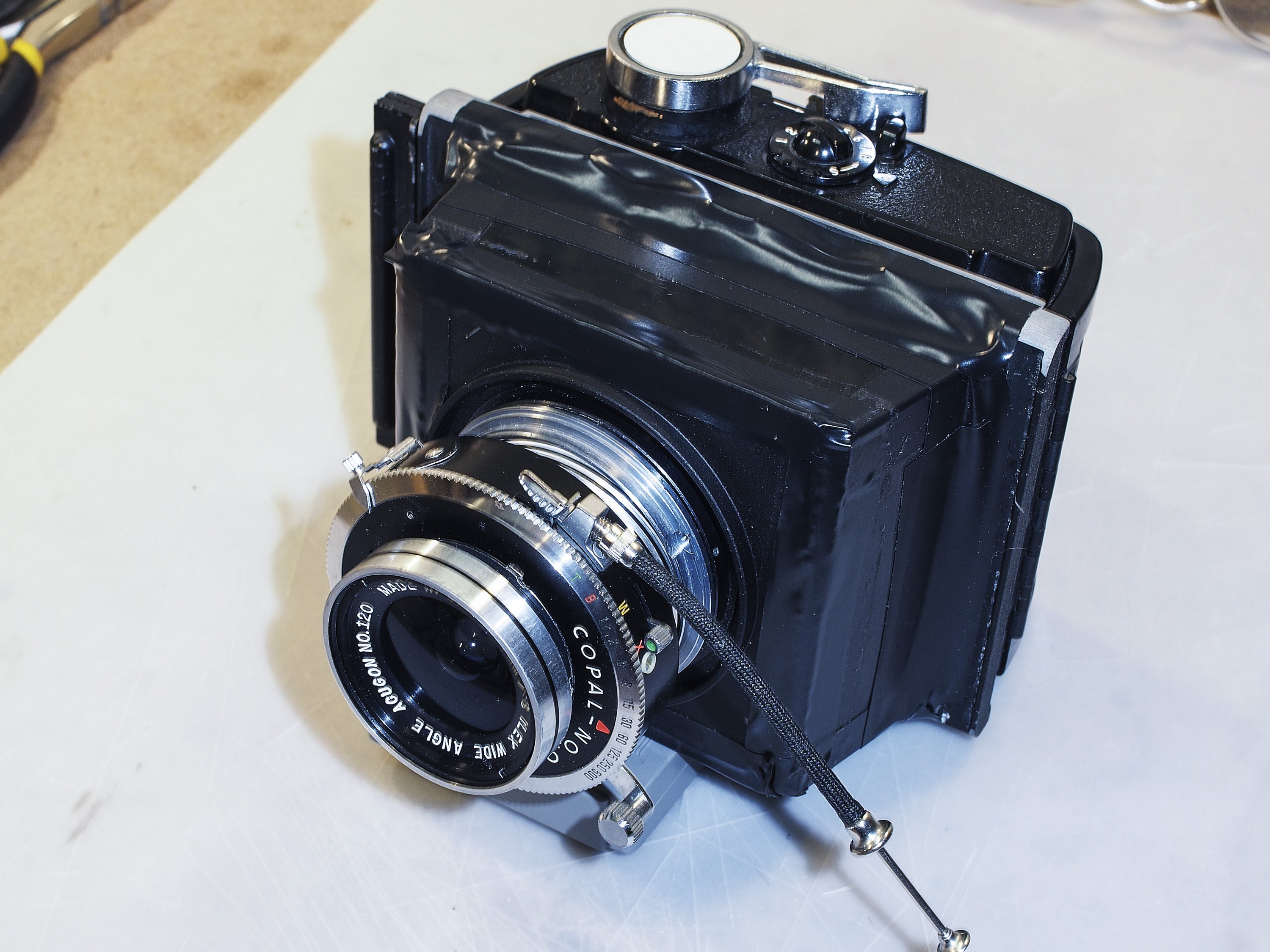

We're there other interchangeable back cameras of this type? I vaguely recall Cambo wide angle cameras from Calumet's catalogs. Thanks!
You can make your own. This is a 47mm Acugon mounted to the focusing helical from a Pentax 50mm lens with an ABS plastic box. The rollfilm back attaches to what was the back of a B&J press camera. It wouldn't be hard to make a Graflok or such back. Guesstimating focus after making marks in the helical travel based on a ground glass at the image plane. I have a junky little 21mm (35mm equiv) finder but have found after a couple of rolls that just guessing the framing works well. I use it for street fun.

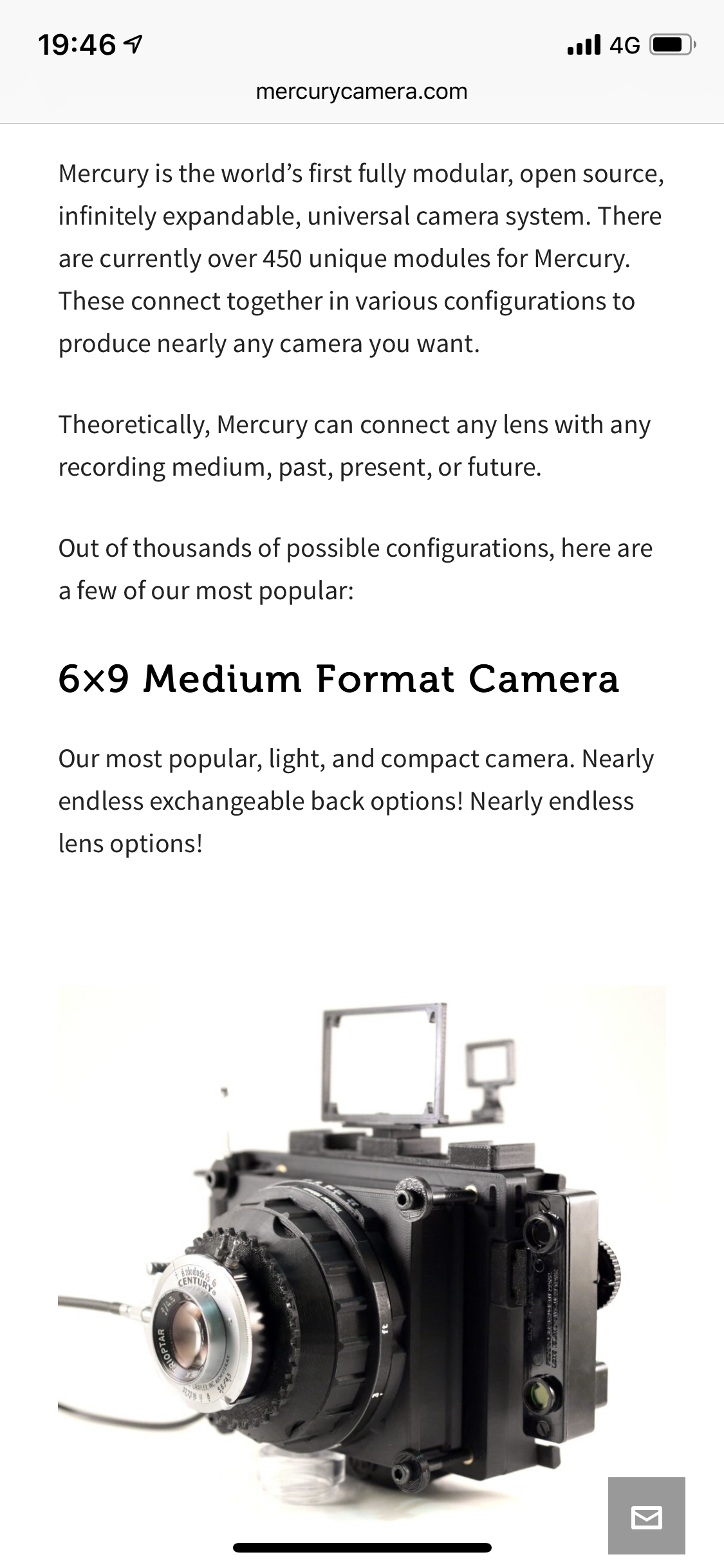

CF6495D6-C100-45BD-91BE-8375B4DEB14D.png Check out MercuryCamera.com, a 3D printed modular system that is built around the Graflok back and a modular lens mount system that accepts view lenses, MamiyaPress lenses, other system lenses with adapters. They recommend old-fashioned type accessory rangefinders to read distance and set focus. Or fround glass. These would work with the Convertible Horseman, as well, of course.
