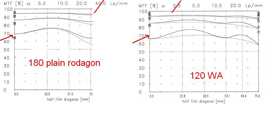

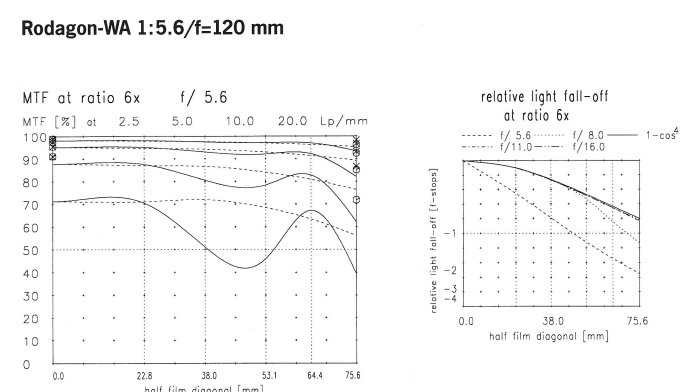

Bob, this is the Rodagon W.A. 120mm fall-off, well stopped it follows the cos4 rule, no surprise.
By f/8 in a 4x5 negative ( x6 enlargement) it has slightly more that one stop in the corner point, and by f/11 it matches yet the cos^4 rule, delivering 4/5 of an stop fall-off in the corner point.
...this is a well noticeable fall-off. I would use a 120mm W.A. (Componon or Rodagon) to compensate the fall-off of the taking lens that thins the negative in the corners, so less illumination in the corner helps to sibtitute some dodging.
Looking the same graph for the 150mm it delivers 3/5 of stop in the corner point but we have 1/2 stop at around 8mm from the corner. If our enlarger has room enough, a 180mm works better than a 150mm and the 120 w.a. , regarding fall-off, still we may want some fall-off from the enlarger's lens to compensate the taking lens fall-off, of course !!
What is clear is that cos4 rules by f/11 in those lenses.
https://nielspn.dk/files/rodagon rodagon-wa.pdf

Problem is that the Regular and WA graphs show different curves. The regular Rodagon shows 5, 10, 20 and 40 lp/mm while the W.A. shows 2.5, 5, 10, and 20 which is a graph more suitable for worse lenses.
OK, let's erase the missleading information in the graphs, I removed the excess field in the plain 180 (to cover 4x5"), the 40 lp/mm MTF curve in the plain Rodagon MTF and the 2.5lp/mm curve in the W.A. graph. Now we can compare. The WA peaks slight lower in the center (20 lp/mm), for the rest we have the same.
Still we have the sample to sample variability, but what Rodenstock technical literature says (and I strongly belive that it's quite serious) is that the plain Rodagon is at least as good as the WA. Also it's totally true that (for 4x5") the 120 WA has a quite remarkable and noticeable fall-off compared to the 180.
Technical information from Rodenstock is quite serious and much a better reference than presonal subjective impresions, still everyone should use what works for him.
Let me reiterate that many people missinterpreted the technical graps (2.5-20 vs 5-40 lp/mm graphs) to end saying wrong things, originating that urban legend.
