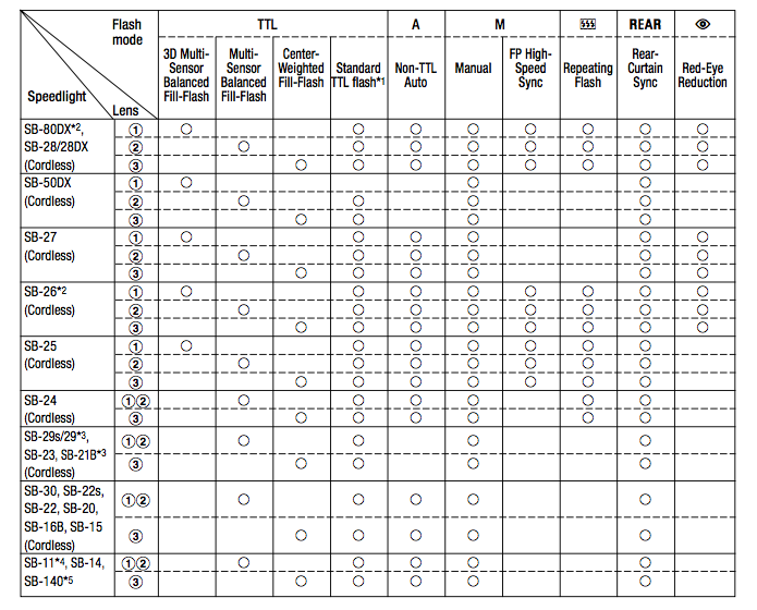

SB-28 is a great flash for film photography. Works with all Nikon film cameras, most with TTL. The flash can also be used in non-TTL auto on just about any other camera from Minox to 8x10. I specially like the flash when using my 18mm lens on 35mm and 40mm lens on 6x6 format due to the SB-28's wide angle of coverage.

No, as mentioned the F100 is TTL capable. If it matters either the SB-26 or newer SB-28 speedlights (both TTL) would be considered period correct and fully compatible with the F100. There were other models available during that time as well but those two models were Nikon's flag ship speedlights of the day. I'd go with the 28 myself.
