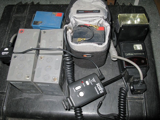

Comparing Metz handle units
Dittos to Q.G. on this one.
I have a couple of 60 CT's somewhere... have not used one in years.
The battery packs are a pain in the a** and ridiculously expensive.
I now use a pair of 54MZ's and love them. I use standard (buy off the shelf anywhere) 6 volt, 4.5 amp-hour batteries. I made the quick-release battery cable from a good quality audio jack soldered to a quantum battery insert.
The belt-loop on the lens pouch wraps around the light stand or tripod leg.
My battery "case" is a small lens pouch. $12.00.
The batteries cost $8.00. (1/10 the cost of the Metz)
The quantum part cost $25.00.
*Forgot the obvious, the $8.00 batteries are rechargeable.

Q.G. and I have had this discussion before :smile:.
I think that the most important things to take from the discussion are:
1) if possible, you should handle the options yourself, so you can gauge the differences; and
2) YMMV.
FWIW, the grey cubes shown in Thomas Wilson's photo attachment shown above are the batteries used in the Metz 60 CTs.
