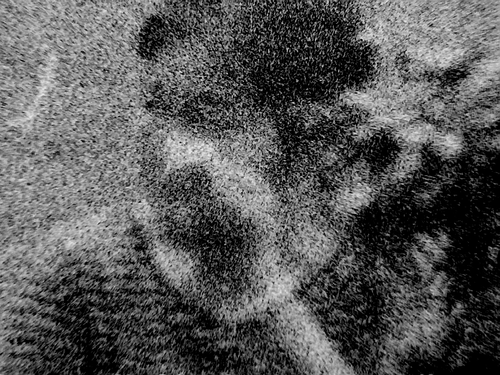

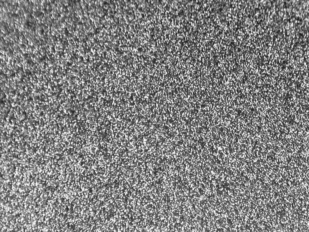

So a brainwave I caught, and it drove me to compare grains that various developer produced. I chose 10x objective and a eyepiece camera which IDK its magnification factor. Maybe 15x I guess. Sheets I selected were both Foma Retro 320 Soft, yes only two sheets in same case so that I can control variables well. One sheet was developed by Rollei R09, a variant of Rodinal. Dilution 1+300, 24C, 180min, agitate 10s every 60min. Another was result of Xtol stock. Developer temp was 21C, agitate 10s per min.
This is R09.
And this is Xtol.
Obviously, R09, though diluted in such a crazy ratio, still made sharper and larger grains, they are violent under microscope. Xtol's seems much finer, I think high solvent cause the fact.

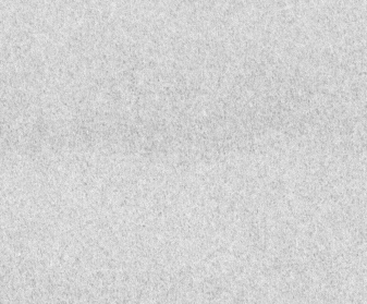

BTW, I also made some shoots check whether my Epson is sharp and focused well or not. It's not bad, right? And I shouldn't use Retro 320 if I'd like to achieve higher resolution.
This photo was shot with microscope.
Hard to tell; it's a 4x5 sheet we're looking at, so even a somewhat fuzzy scan at this size would still look sharp. But at this size it certainly looks just fine!

For the grain comparison, did you select areas of equal density on both negatives? I admit the comparison I posted is sloppy in this respect. Grain renders very differently depending on density - and the way it's observed (photographed, scanned, enlarged) also makes a big difference. It's quite a tricky subject if you think about it. Overall, your observation of course rings true - R09 stand developed for a couple of hours will give much coarser grain than XTOL.
Unfortunately, my densitometer passed away last year, then I used my spotmeter to find two area that were both 90lux. Highlight with red arrow.
