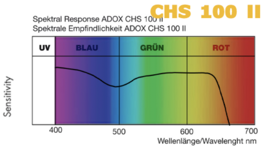

I haven't used either of these films (and I'm not that keen to start paying Ferrania's prices). I'm wondering how my CHS100ii would compare (not trying to set you extra homework here!) - that's described as orthopanchromatic, and I know I like what I've done with it, but I haven't done a side-by-side trial against either a pan or an ortho film. Not sure if I have any ortho right now - if I have it's old (but I can get Ilford Ortho over the counter in town, it seems).

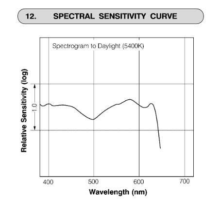

Most likely, CHS100 II would render reds much lighter than P30, and only slightly lighter than a known orthopanchromatic film, such as Acros 100. Sadly, there is no spectral sensitivity graph available for P30...
