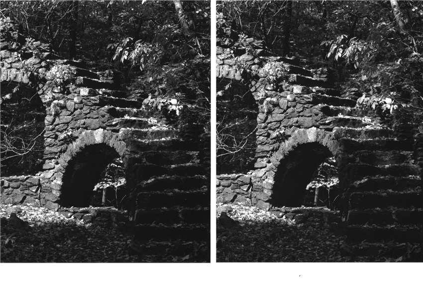

I did my own comparison in 4x5, the difference in looking at the prints is very subtle, and I can only tell the difference by looking at the notes on the back of the prints.
I'd say the only meaningful comparison would be one you do using your gear and evaluate with your eyes. None of the rest of us viewing the result will see the difference.
Right Xtol 1:1 Left Pyrocat HD
Please label which is which.

bdial: I am 99% certain that this is the comparison I saw somewhere (else). Can't remember. But thanks for re-posting it here. This was really helpful in convincing me to spend less time on picking a developer and more on sharpening my photography and development skills. Since then, I've seen more folks post the same conclusion (or write in textbooks... like "Way Beyond Monochrome"), and that's been enough to convince me that as nice as Pyrocat-HD is, it's not a magic bullet and maybe the Toxic Level 4 warning suggests I should take a look elsewhere. I'm now focused on simpler stuff like Perceptol when speed isn't critical, and XTOL or ID-11 for everything else. Haven't played with any of the 2-part developers (Barry Thornton's, Beutler or DD-23) once touted as "better for zonies and roll film", but maybe another day. Thanks!

@JWMster, I've posted it threads in here a few times, and it's in my gallery/media collection which is where it was posted initially.
...This was really helpful in convincing me to spend less time on picking a developer and more on sharpening my photography and development skills...
Yes, that was my takeaway from the exercise, pick a developer, any developer, that suits your preferred working methods and vision, then move on.
That said, staining developers have their use, especially if you're looking to produce negs to print in silver and alt processes because of the slight contrast masking provided by the stain.
When the print is up on the wall, no one, except for a photo geek, will ask "what film or what developer?"
And then, 9 times out of 10, he/she won't understand how you got that result with that combination.
I know I've been there.:smile:
