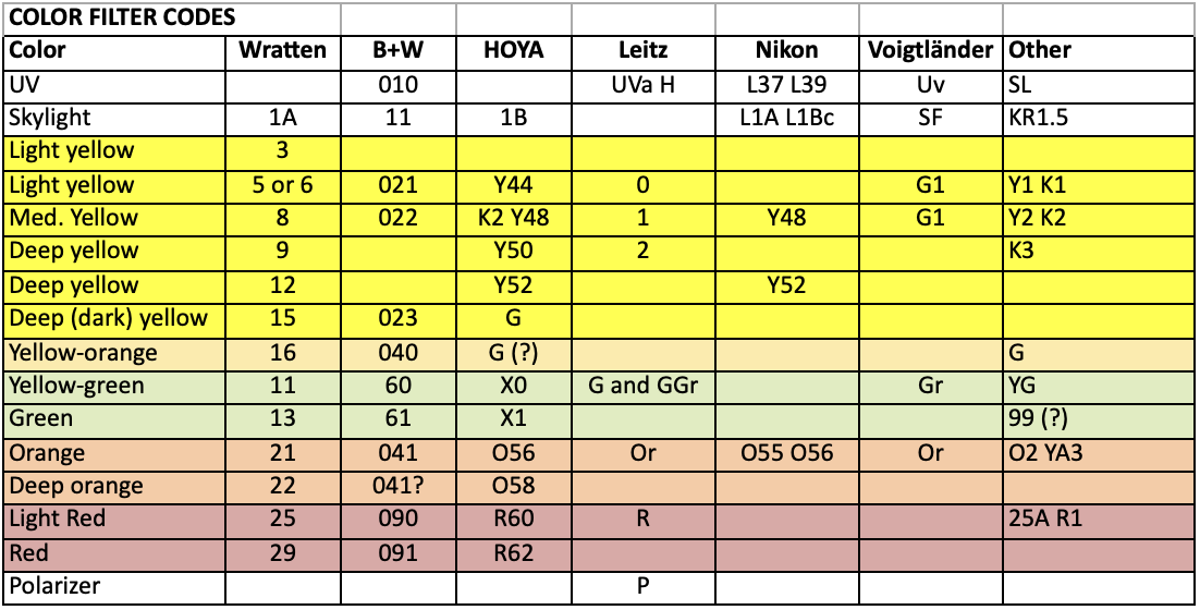

Different companies used many designations/codes for their color filters made for black and white photography. It often confused me if Brand A's filter xx was a similar color as Brand B 's code yy. For example, G is Gelb (yellow) for German filters. But Leitz used G for Grün. And Kodak used G for orange or yellow-orange. Argh. Finally, I ended up with so many filters, I had to make a comparative table. I posted an earlier version of this table in another thread, but MattKing suggested I post it in its own thread.
(Note this is an analog content area, but some digital photographers are using these color filters with their monochrome sensor cameras).
If you look around, you will probably find even more odd nomenclature. Please let me know if you see any errors.

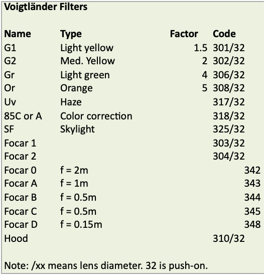

Voigtländer filters from the 1950s and 1960s were another muddle. The boxes show a code, not a color! Here is the best I could sort out.
