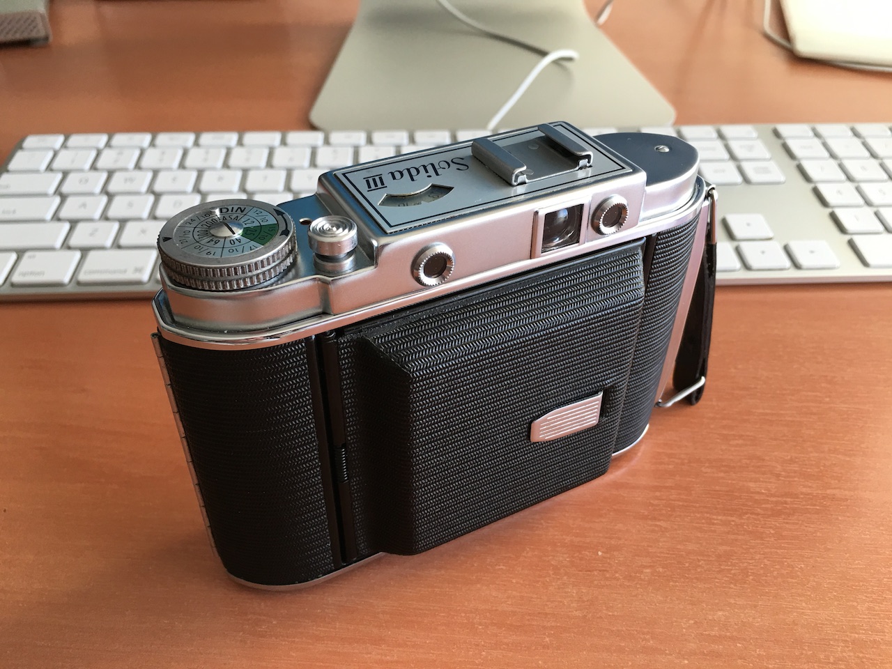

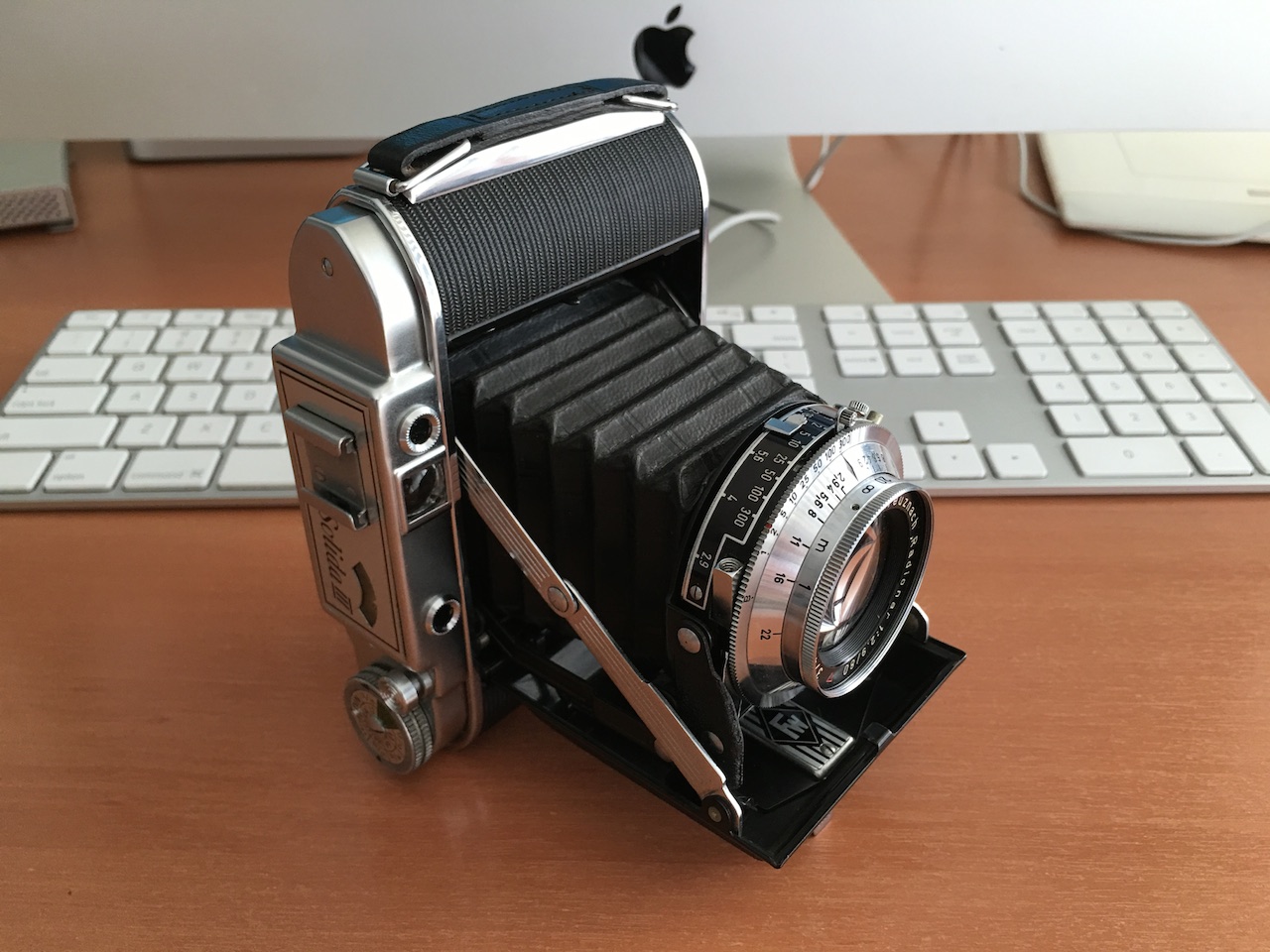

You can't go wrong with the Franka Solida IIIe. Compactness at its best with a stunning lens.
Photos of the camera and some recent shots below:
