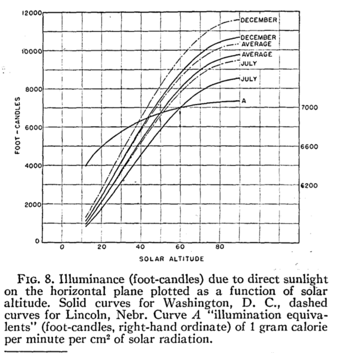

There are a number of known variables that affect film exposure in sunlight.
