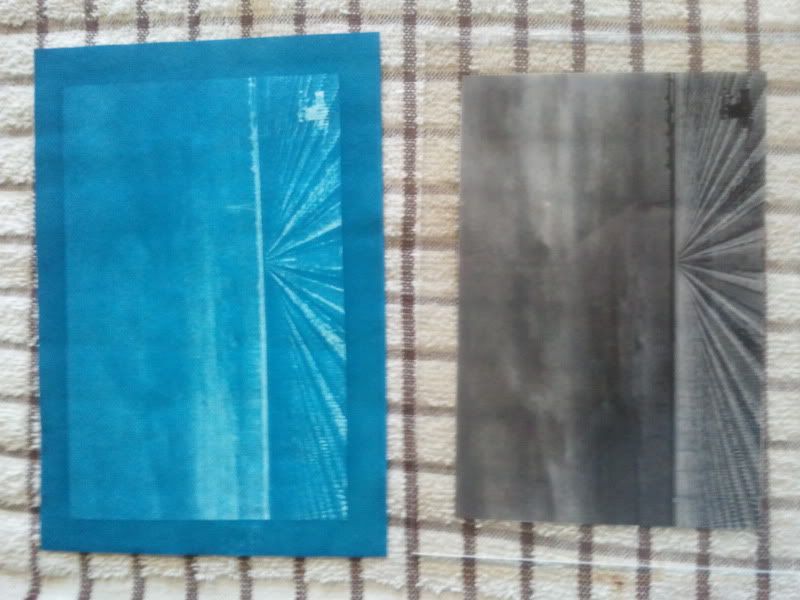

Just did my first print of a oiled paper positive using the info m1tch provided in his thread. This one is a bit over exposed at 13 minutes in sunlight. I lost a bunch of mid tones. The paper positive is a very low resolution laser print, which doesn't seem to matter much on this scene. I'm going to try 9 minutes on the next one.
Oh, the prints I did yesterday did oxidize fully and the blue spotting went away. I can see how this gets addictive! Great fun!

I shortened my exposure time to 7 minutes ad got much better mid tones. I wish it was a higher resolution print for this one, but it looks ok I think.
