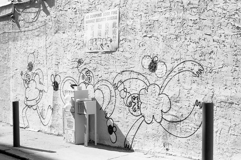

I've developed a few rolls of film now. Initially, made a few errors with chemical dilution (aside from destroying a roll of film by physically mishandling it as I posted in a previous thread).
The last roll I developed using TMax 100. I wasn't super happy with the results, but it's a step in the right direction from my first rolls. Scanned using epson 600. Here is a google photo gallery of that roll: https://photos.app.goo.gl/gHXVpJcxaJsqXszt8. (sorry don't know the best way to share a picture on this site - tried to post a jpeg to one of the threads and it said the file was too large - not really a big computer person).
Just kind of thought those photos looked really dull and flat in comparison to other 35mm black and white I've done like this one I just got done at a pro shop in my city. I was pleased with how they came out - more contrasty and greater depth. https://photos.app.goo.gl/Bpwaca1CDtr2Zc3m6
Thought it was a good idea to get one developed professionally while doing some on my own in order to see the difference.

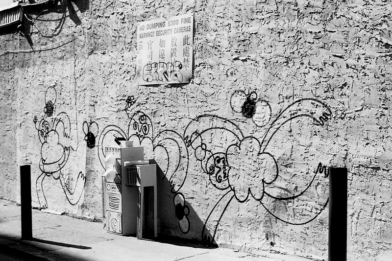

TMax in DDx has the potential of giving great results.
What you are seeing is merely the differences in scanning.
If you want to upload something here, you need to resize it so the longest side is around 800 pixels.
I went to the upload link you posted, copied one of the images and resized it appropriately.
I saved that version, then made some simple post processing changes, and saved the result as a separate file.
I've attached both versions, to show how just a little adjustment can make a big difference.
Remember, both versions come from the same scan.
View attachment 224824 View attachment 224825
Whoah - thank you so much for demonstrating that! What do you use to edit the photo like you did? A particular computer program?
That one was just a quick couple of edits in a useful piece of "software by donation" called FastStone Image Viewer - you can find it here: https://www.faststone.org/FSViewerDetail.htm
Besides being quite capable generally, it offers a really flexible image re-sizing utility.
For more complex stuff, I use Corel's Paintshop Pro.
