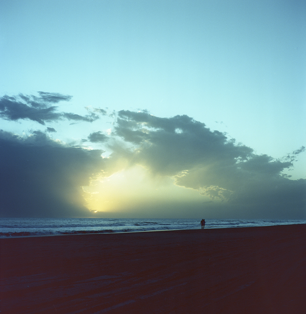

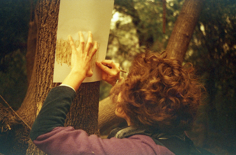

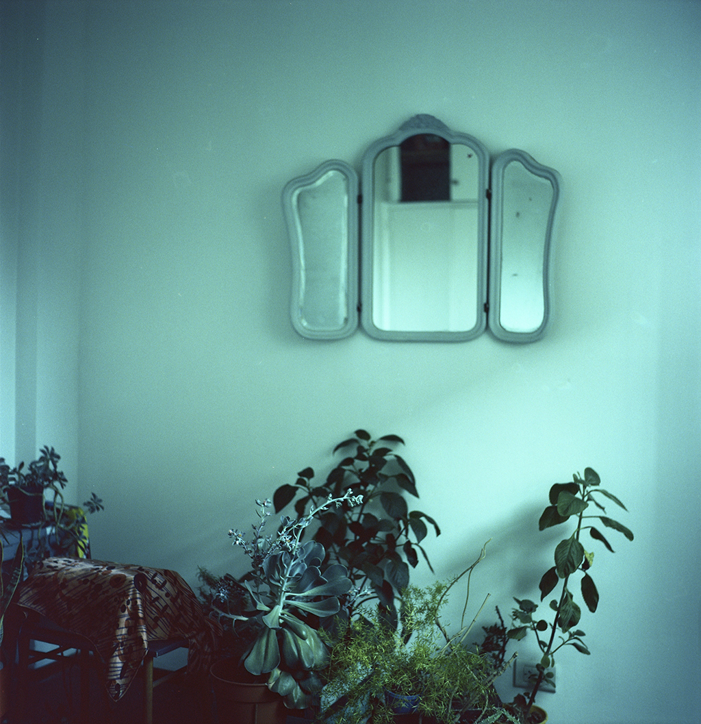

I've experienced this same problem twice, developing 120 kodak portra (expired 4 years ago, but kept in the fridge) in kodak flexicolor chemicals (same brand but different mixes, the first was in a lesson, mixed by the teacher, the second was at my lab, I had mixed it the day before).
The problem is color: cyan in the highlights and red in the shadows. Besides, in the second opportunity the complete film turned green (instead of caramel/orange).
process was the following:
temperature of all chemicals was 38º
prewash: 3 minutes (changed water in tank 5 times)
developer: 3.15 min (Initial agitation for 30 seconds, followed by 2 seconds of agitation every 15 seconds.)
wash
bleach: 6:30 min (Initial agitation for 30 seconds, followed by 5 seconds of agitation every 30 seconds.)
wash: 3 min
fixer: 6:30 min (Initial agitation for 30 seconds, followed by 5 seconds of agitation every 30 seconds.)
wash: 3 min
final rinse (stabilizer): 1:30 min (Initial agitation for 30 seconds)

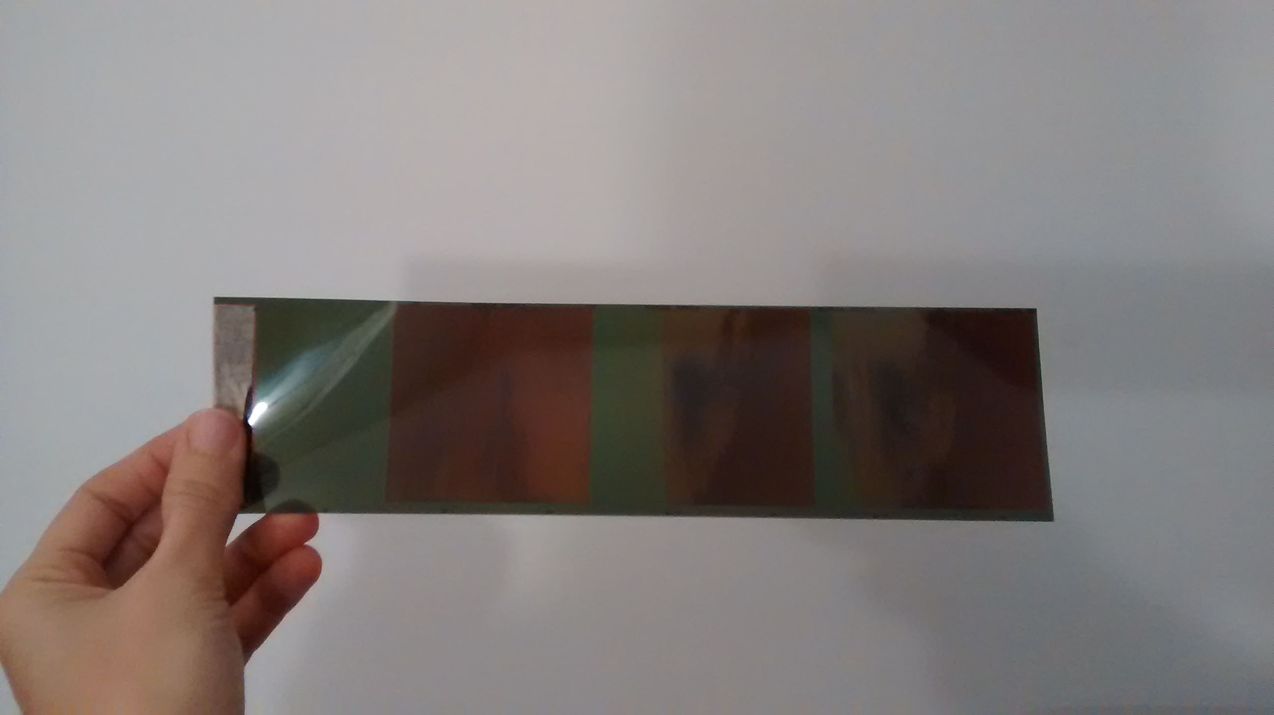

these are some examples of the scanned negatives, and a picture for you to see how green the film turned out.
I would love to hear some opinions and advice since the person who taught me the process does not know how to help me and I definitely don't want to waste chemicals nor film!

Provided your chemicals are fresh and it looks as if they are from what you say, then I can see nothing wrong with your process. The only "wrong" thing I can see is the out of date film which may or may not be the problem. Were there other students developing film in the class as well? If so did they use the same chemicals and did they have the same problems. If they didn't then it seems almost certain that it was your out of date film

Thank you for answering pentaxuser! Chemicals were fresh when I mixed them (cannot prove they were fresh in the class). And no, there weren't other students in the class. I'll try developing in the same conditions but with no expired film, but I still wonder if it is something that I am doing wrong, since I have sent two rolls of this same expired film to the photolab and they developed ok!

Are you 100% sure that the scanning process didn't mess up colors? Unless you do test strips and color charts plus density measurements, there is no way you can tell from scanned images whether negative colors are off ...

Hi rudeofus, I am quite sure it's not a scanning issue since the film already looks wrong (see third picture).
I don't have access to a color enlarger, I guess I would need one of them to do those test strips you mention, wright?

If the space between frames is indeed green as shown, then yes, something is off. Somehow the red sensitive layer got fogged, likely by old age. You should be able to correct quite a bit of fog when you post process the scans. If you have many of these old rolls, you could try adding some extra Potassium Bromide to your color developer, a starting amount of 0.5 g/l may work.

Contamination of developer with bleach or fix could also cause this fog.
However, the process as outlined is just fine. The pre-rinse and the other items mentioned are not the cause of this overall color unless there is a contaminant in the water.

Unless there is a contaminant in your water supply, or you have somehow contaminated the chemicals or fogged the film, there is no other answer I can give you. I have worked on and coated color negative films and worked on the process development of C41 and know of no other sources for this problem.

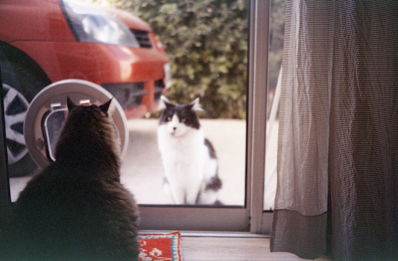

Hi to everyone following this thread. Once again, thanks for all your helpful answers. I want to tell you all that I developed 35mm film some days ago. I repeated all my steps but did not wash between delevoper and bleach. I like the results best, although I have some inconsistency throughout the roll: some have realistic colors and other photographs' temperature is too warm. I attach two examples of both cases:

Are these scans? It's hard make conclusions about color accuracy from scanned frames. Also, if the frames are from the same roll, I can't think of any reason (or way) that some frames would develop with correct color and others not.

The "reddish" shot looks quite underexposed, too. Either you see an artifact from the scanner software trying to correct a underexposed negative, or maybe this shot was taken in the evening during sunset ...

Great! I hadn't noticed that constant when I examined the developed roll. Most (if not all) of the pictures that turned out with those red and yellow tones are underexposed. I used an old olympus trip, as its selenium exposure meter does not work I got many underexposed photograms. Thanks rudeofus and bvy!

Well, the negatives above have clearly been chemically or light fogged! There is no question.

The only negatives presented are before the positive images above. No determination can be made from the positive images. Raw visuals or scans of the negatives, as is, is the best indicator.
