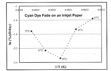

How about some confusing real data? This is a real test on the stability of a digital printer dye under different conditions. The data seem to make no sense, but they do really when you consider that reactions take place differently at different temperatures.
As for the Wilhelm Institute, I remind you that they are sometimes funded by industry (but never by EK) and that they have never published data in any peer reviewed scientific journal. Other agencies and companies have done so.
I refer you to the ICPS book on image stability. It is available through ICPS. I have published the relevant information here a while ago.
PE
