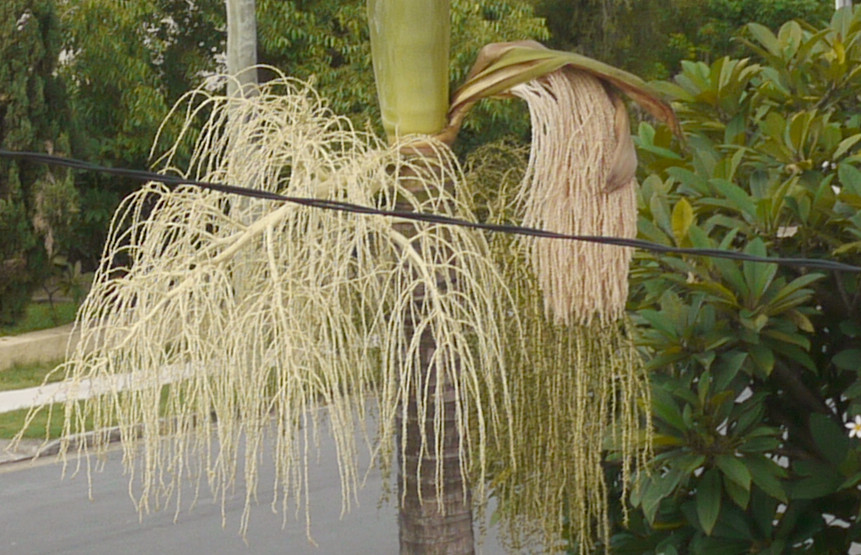

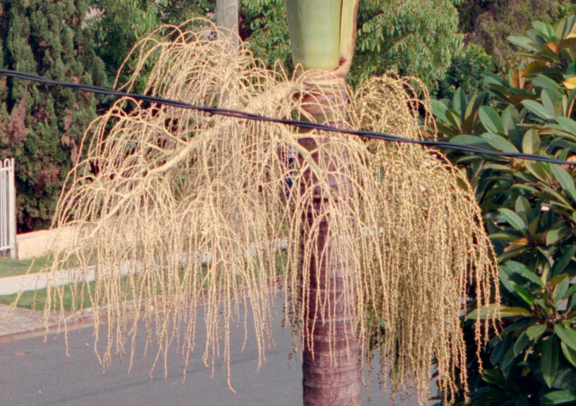

PS: this weekend I tested a Bessa with Negative. I was so impressed I took a digital with my Panasonic GH1. Talk about chalk and cheese.
http://cjeastwd.blogspot.com.au/2013/04/bessa-i-with-colour-skopa-lens.html
as my monitor was not colour balanced I didn't try hard to get the colour right. None the less the differences between renderings and detail are startling.
Film
Digital
On the neg the trunk is about right, as are the fruits on the palm and the greens of the frangipani tree leaves (red channel seems to have the wrong HUE cast) ... yet overall neither represents the scene as it was.
With work either could do well, but the 120 negative strikes me as having better potentials
