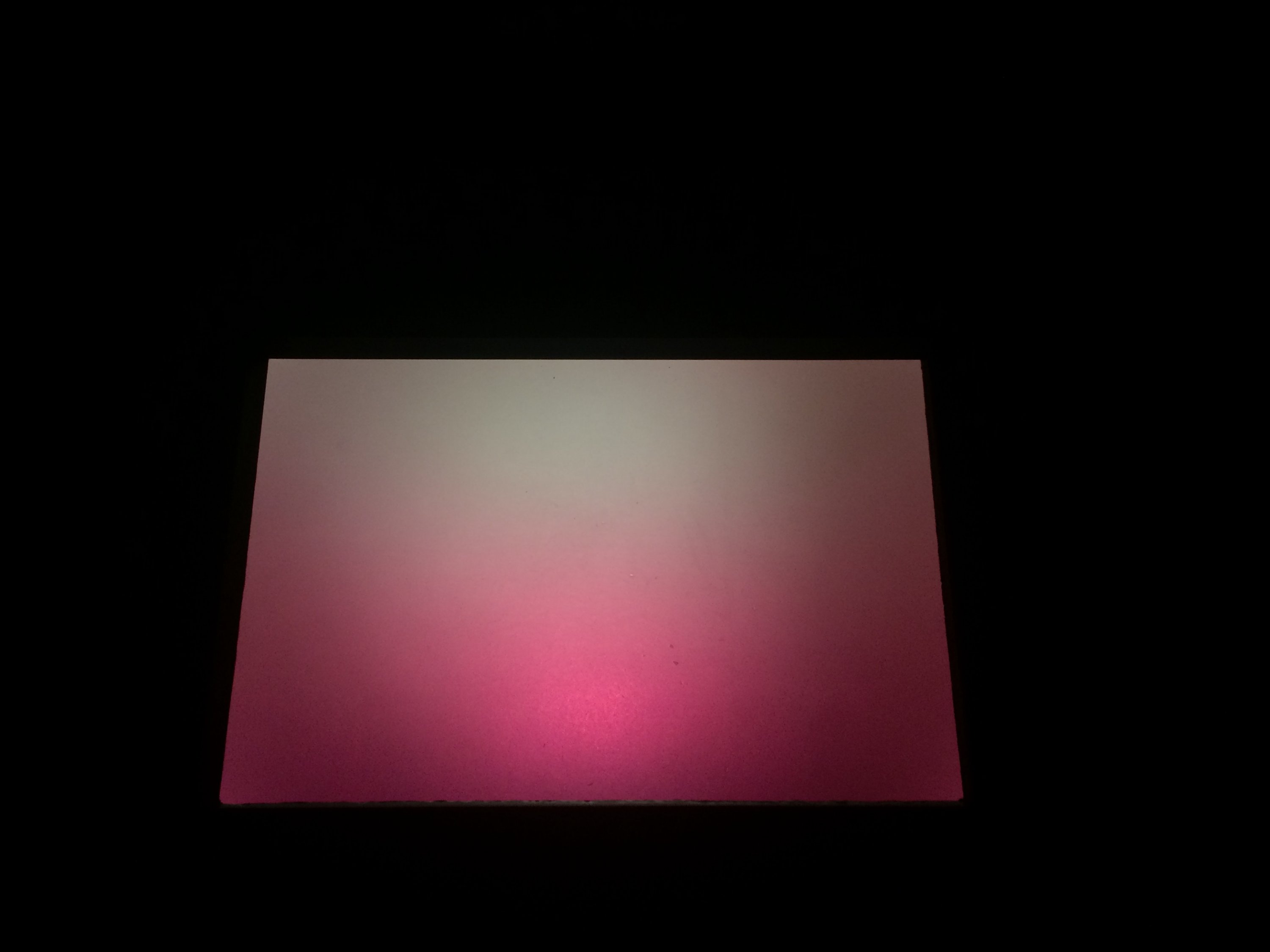

Hi all.
Have just put my colour head onto my durst m670 for the first time and when the lamp is lit I’m getting very uneven colour across the base board (please see attached pic) Haven’t made any prints yet as new darkroom isn’t yet ready. Have never noticed this on other colour enlargers I have used, but then never cared to look. Is there something wrong with the filters on the head? Or am I being stupid?! By the way, in the attached pic the filter pack is set to 70/70/0.
Thanks in advance.

koraks
Nov 29, 2018
21,243
Europe
I'd inspect the inside of the head and particularly the construction around the dichroic filters and the light mixer. Seems like something is very wrong there. Check for loose or missing parts; this looks like a fairly fundamental defect.
RalphLambrecht
Sep 19, 2003
14,588
K,Germany
I agree,something seems misaligned. This will lead to uneven loighting and contrast.
Dec 24, 2016
390
Asturias, Spain
Mine's a Meopta colour head, but that looks like the mixing chamber is totally absent. There's no way that I can see to get that effect with the mixing chamber in place.
Chan Tran
May 10, 2006
6,690
Sachse, TX
Yes I think so. The mixing chamber is missing. The dichroic filters would partly cover the lamp depending on your setting. So without the mixing chamber that what you would have.

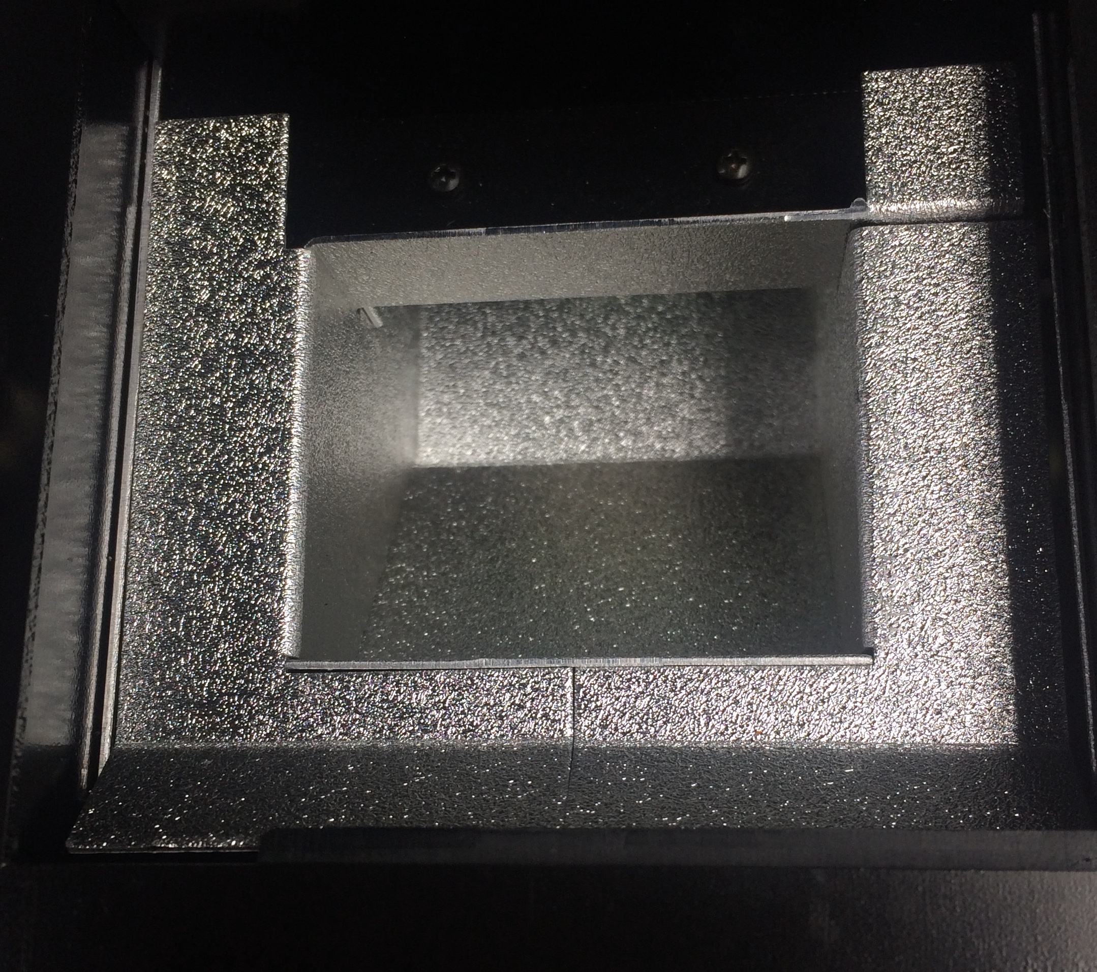

SteD
Aug 29, 2018
53
Uk
Here’s a shot of the mixing box.

AgX
Apr 5, 2007
29,973
Germany
I admit I am puzzled... Actually I meanwhile think that with a mixing chamber missing likely hardly any light would enter the lens at all anyway.
We must have overlooked something. I guess I better sleep over it...

A frosted pane at that position would not blend the light sufficiently to overcome the OP's issue.
