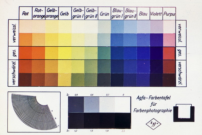

Hello all,
I have some colour pictures, that I would like to colour correct/grade, so that the colours match those found on a referance colour chart (please see attached picture). Does anyone know how I might be able to do this accurately (100% match colour to colour, not eyeballing with the sliders) using Lightroom, or normal photoshop ? Directing me a tutorial if one is not inclined to explain herein would also be more than welcome. Thank you in advance for any response

I would suggest 3D LUT Creator. You will have to figure out how to map each color chip to the perceptually closest color in a standard MacBeth Color Chip Chart, but it will then build a Look-up-table to map these colors to your image and it is compatible with Adobe Photoshop.
https://3dlutcreator.com/
They are having a Halloween Sale now; a good time to same some money if you decide to purchase the program.
Oh, and come back and show us your results! This looks like and interesting project!
What AGFA process does this emulate?

Thanks for the answer Kino. If I am understanding you correctly, within this 3D LUT Creator program, I will be able to match some of the colours of my referance chart to that of a digital MacBeth Color Chart situated within 3D LUT, which in turn will create a colour profile that will be able to be applied to pictures entered into the same program ?
As for the color chart I am looking to emulate, I am not entirely sure where its derrived from. I found it looking at resources around Autochrome-like plates made by Agfa, but I am under the impression that this chart does not reference this exact process, but is probably a general color chart used by Agfa to make corrections and arrive at what they perceived as desired colours.

Can someone explain why you would want this done? How does a program know what is the "correct" color?
I just want a program to automatically adjust the various colours in an image to match those of the colour chart. The result will hopefully be that the resultant colours of the picture will be rendered in a way that emulate Agfa Film.

How does it know which color is which?
I imagine using a picture that contains a colour chart to create the required adjustment profile, which could then be applied to the rest of the pictures. I do not imagine a program is yet capable of distinguising colours organically in the picture and correcting for them.
More or less; it is simply a set of look up tables (like a spreadsheet for colors) that remap one color to another. The program doesn't have a MacBeth color chart inside it, but it does have a "standard response curve" for how colors should look in any give colors space, such as Adobe RGB or Rec. 709 (HD TV) or whatever.
It seems this guy has a tutorial on how to generate, save and apply a LUT in Photoshop:
See if that works for you.
Well, regardless of what Agfa wanted it to represent, it is a representation of the Agfa color space via the printing color space they used to reproduce it. It could only be exact if you had it printed onto a copy of actual film it was supposed to represent and that's not going to happen, so fake it!
In any regard, this sort of thing is easy to over-think. Try the above tutorial and see what happens...

Use the 'do what I want' (DWIW) button of the program, to make colors automatically match what it has no idea what to match as a reference!
If your reference chart has provided 60 numerical R-G-B values for each of the color patches of the sample in OP, an automatic match becomes feasible. Otherwise, DWIW applies.
