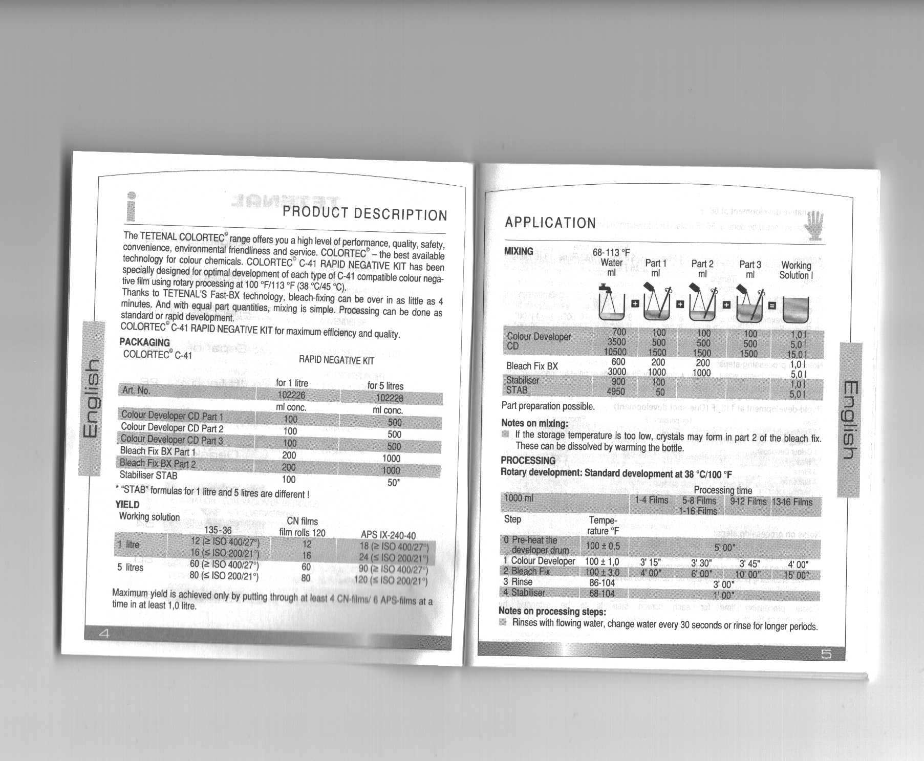

Hi Thank you for everyone's help I have 1 more question I have got the Tetenal C41 Kit 1L I was wondering if anyone could help me on mixing up the correct amount up to fit in my Film Canister. The film canister I have holds for 1 35MM film 290 ml
I have attached The Instructions. also where do I find a chart on developeing times for colour Films
Thank you

Can't help with the colour chemistry,but I would advice that you use 300ml instead of the 290, that extra 10 ml can make life a lot easier, and it alwaus better to have a little bit more in the tank as film reels can slid up a tad, and you can the top of the film bot developed enough, also, as I understand it, all colour films in c41 have a standard developing time, so you don't need charts as you do for black and white film
MattKing
Apr 24, 2005
53,272
Delta, BC Canada
As others have posted, your instruction sheet does have the answers to your question, but just in case the form of notation isn't clear to you ...
Times noted in the standard form {6' 00"} mean 6 minutes and 0 seconds - in other words the ' symbol is used for minutes, and the " symbol is used for seconds.
