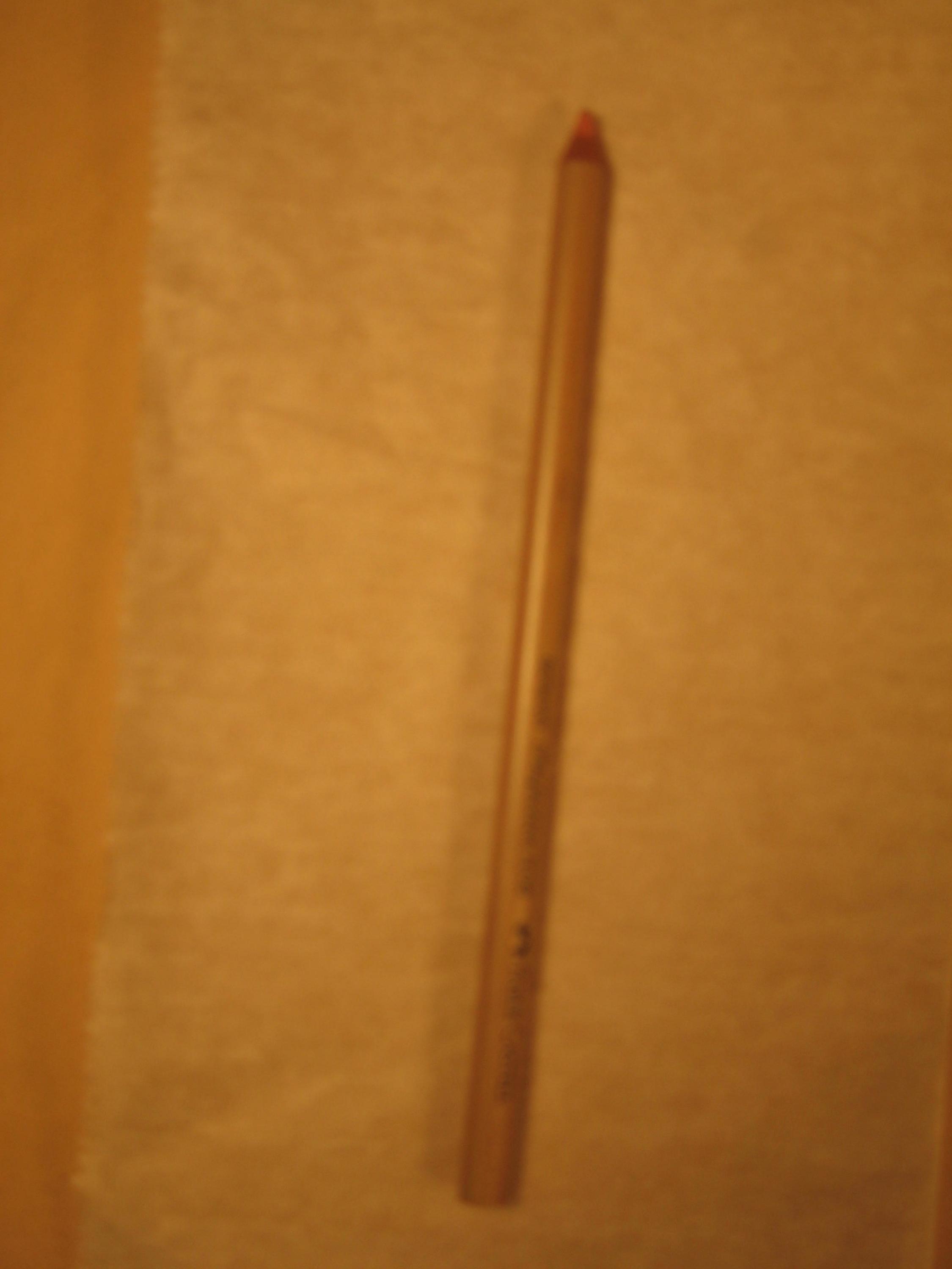

I know a lot of people use turpentine, or oil, to smooth out the finish, but I never do. Adding anything to the surface will attract pollen, dust, etc. (as well as lengthening the drying time. Instead, I use erasers to smooth out the texture from the pencil lead. Find some of these, with the pink eraser, for smoothing:
