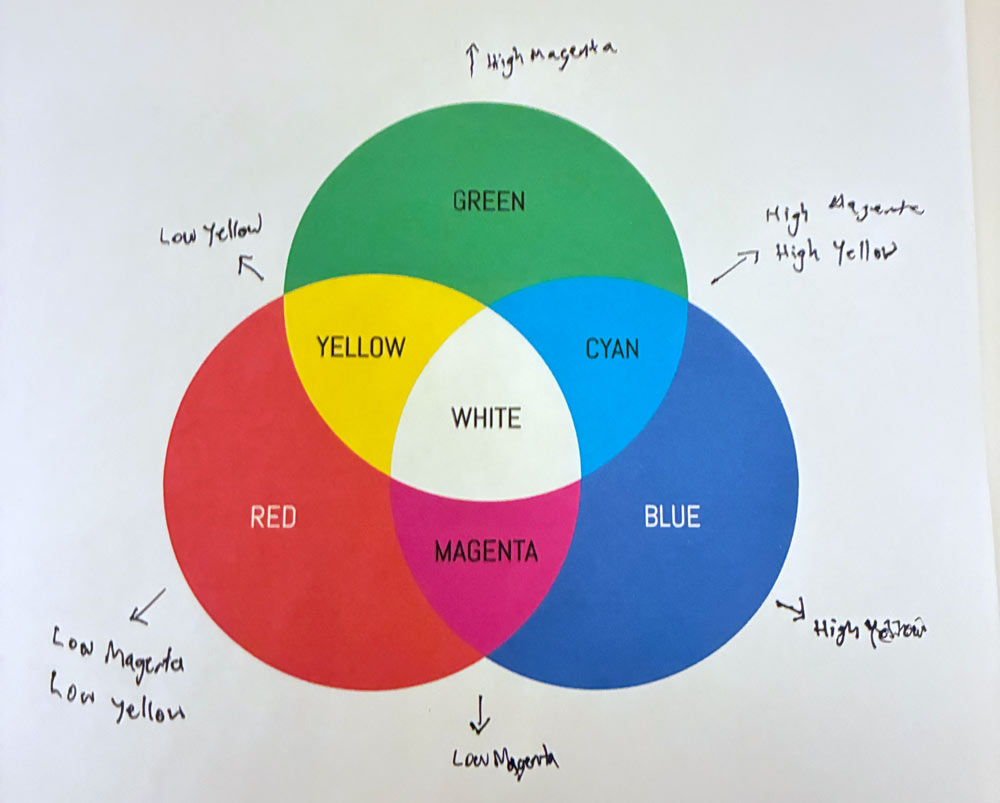

I understand how the Y/M combination moves around the color wheel, as below, however I'm having trouble when starting out with a negative to begin in some place of "white" "neutrality."

Does anyone have any experience/advice on printing on the Dual Dichro, or any tips on the fastest way to achieve a "neutral" print when printing a fresh negative?
Not specifically with this enlarger, but I'm used to working with 'weird' filter settings on my own digital light sources. The ultimate conclusion is that the numbers just don't matter. They're all relative, so don't fuss over the numbers being far off where the manual would lead you to expect them.
The fastest way I know of when working with unknown/new negative/scene lighting/paper combinations is to straddle the filtration you expect to end up at. Ideally, make four test strips:
* Far too high magenta, far too high yellow. This print will come out too green + blue = cyan.
* Far too high magenta, far too low yellow. This will come out too green + yellow = lime.
* Far too low magenta, far too low yellow. This will come out too magenta + yellow = red.
* Far too low magenta, far too high yellow. This will come out too magenta + blue = violet.
If the overall balance isn't too the side indicated (cyan, lime, red, violet), you know your filter setting isn't extreme enough on one or both channel(s). Fix that before continuing.
With a little experience, you can then pick a point that's likely much closer to the final filtration for both channels. Do one more test strip and evaluate where it lands; you can then use this as another benchmark for any further strips.
Visually, it would be something like this. The dotted bar represents the neutral point you're trying to establish. This is not necessarily smack in the middle of the extremes you happen to choose. The consecutive strips are indicated with their dominant color casts. Note that strip 5 ends up being a variant of #2, so you know you have to compensate the same way as if you had obtained the #2 strip, just a smaller adjustment.
Of course, once you've figured this out for any given roll, the rest is basically just printing off at very close filter values to be only adjusted for e.g. changes in scene lighting. Assuming you're aiming for neutral, true-to-life prints in general.
