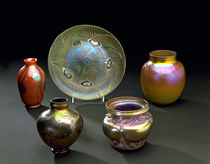

PS: Sone say dung the answer for glass. Louis Comfort Tiffany and his men created the most beatiful color glass on earth with some say with carbonic acid patination and ammonia salts .
A book reports Tiffany irridescent glass has been made with spraying silver or bismuth in to a fire and than from there on to molten glass. When the glass piece went to closed furnace , wait the fire turns to green and they spray tin chloride . They measure the heat with first fingers nail.
Second irridescent formula is dropping in to molten glass copper gold alloy , gold is ruby , copper is amber.
They call these glasses carnival glasses after 20's which Harry Northwood invented poor man's Tiffany and produced every color. I am after that recipe now.
Tiffany example :300px-Louis_Comfort_Tiffany_Favrile_Glass.jpg

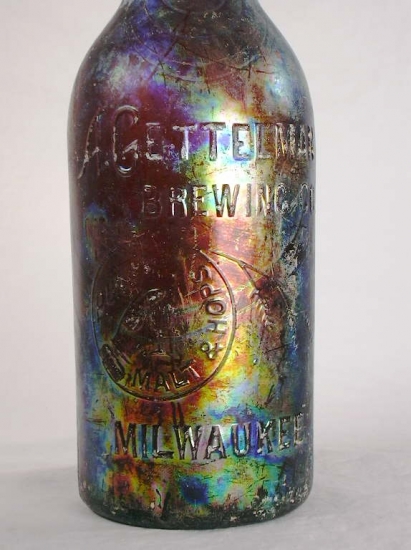

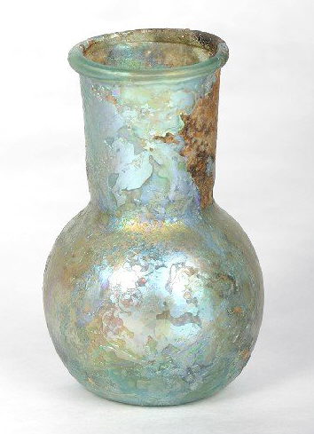

Antique Soda Glass , Surface Soda Loss Glass Examples : 13863db43c9b285e46d96803ac0096a3.jpg6e565345537fc0c44c262fbd7a2f1c51.jpg60b6e69423d7c7412425bc9e505378ff.jpg

PS4: I read many times , Tiffany used Carbonic Acid at his glass patinations but I read silver in glass and tin chloride spray on to hot glass also.. Carbonic acid mechanism is works for antique glass , his works differantiate from the old with non cracked clean and new surfaces. He did see these examples while visit in Europe and when came back to America , he requested the same look from the Nash.

Beautiful both the Tiffany and the antique glass examples. Mustafa wasn't carnival glass pressed glass that was sprayed with liquid metalic salts after the glas was removed from the form? The Dictionary of Glass: Materials and Techniques von Charles Bray has a chapter about the production of iridescence in glass and that's what carnival glass is. Maybe you can get a copy of the book.
Thank you for the explanation of technique of Carnival glass. Important question was glass hot when sprayed or not ? If cold , we can print color images on glass , MDR.
Umut
The glass was hot. To quote the book: "Fuming: This is a method of exposing hot glass to fumes, usually of tin chloride or silver nitrate, to produce a thin interference layer on the glass. This results in an effect of iridescence. In the past it was common practice to place some of the metallic salt in a tin at the mouth of the furnace and to drop a hot piece of glass..into the tin to create fumes. The glass being worked on would then be held into the fumes to create the iridescence. Today's practice is to mix the metalic salts with alcohol or destilled water and put the mixture into a small hand garden spray. The mixture is then sprayed onto the hot glass in an extraction chamber until the required amount of iridescence is achieved. The hot glass is then reheated in the glory hole before being cracked off to be annealed."
