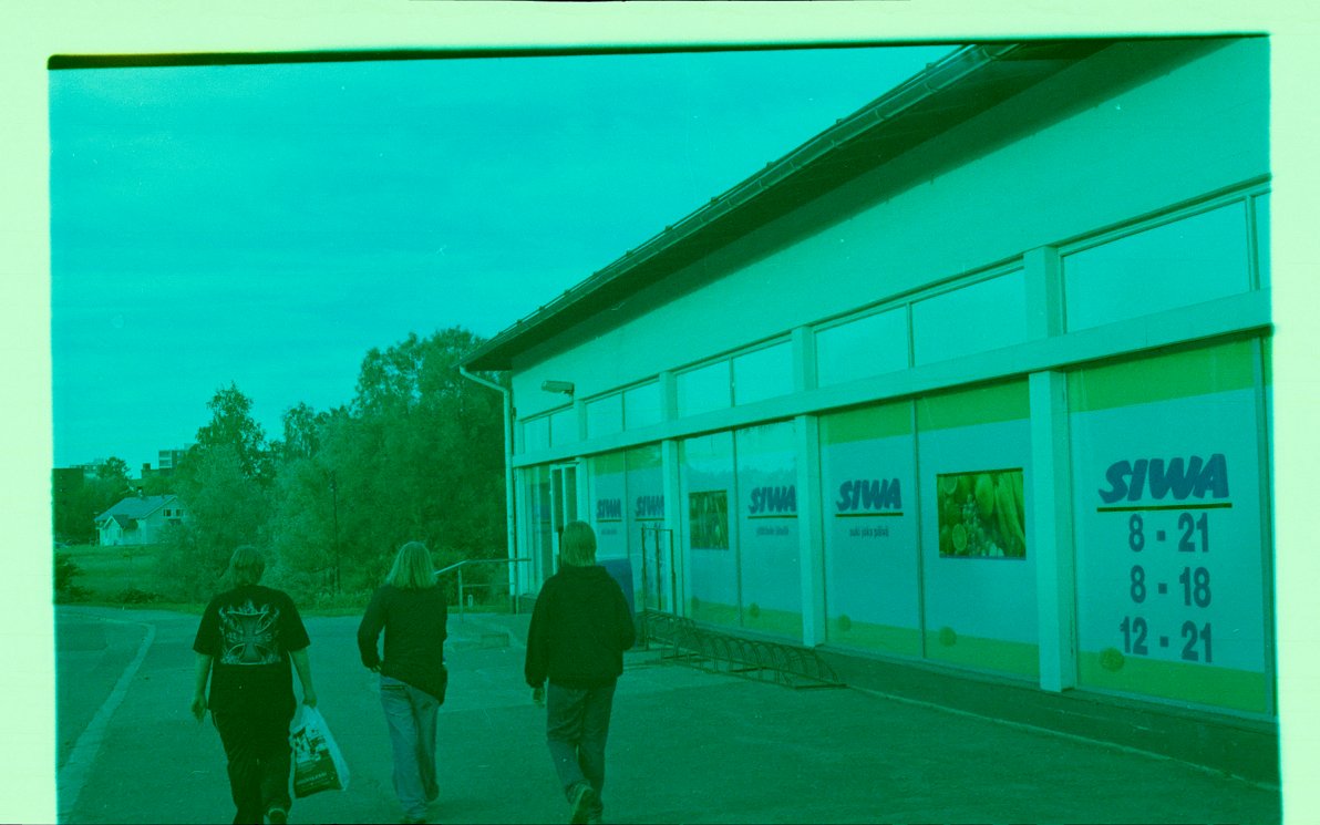

Attachment: Fuji Superia X-tra 400 contact copied to Fuji Sensia 100, then processed either in C-41 or ECN-2 developer. I attempted this only once and made a series of three exposures, without any color balancing experiments.
So, if you find a film that cross-processes with clear Dmin and take some time in color balancing, I'm sure you can get usable results.

You could try to boost contrast by overdeveloping, if you are using a maskless camera color negative film like "Rollei's". Still, it will probably have too low contrast for projection, but try it, it may still look interesting.
You can see the contrast problem in my cross-processed E6 example, even if you forget the greeniness. The "whites" are not bright enough, and the blacks are not dark enough. As PE points out, the contrast will be even lower if you use a normal camera neg film.
