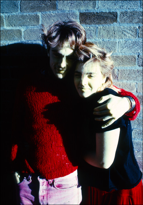

What does a color IR photograph look like? I'm trying to picture it in my head and it's not working.
AgX
Apr 5, 2007
29,973
Germany
Think of psychedelic colours of the sixties... Actually all depends on the subject and of the filter you use.
Mark Antony
Mar 27, 2007
789
East Anglia,
Here is one I took on E4 process Ektachrome in 1986:
the clothes are all the wrong colour (blue jeans black jumper on left, black skirt on right) It was taken though a Yellow filter. Trees and grass would come out magenta faces waxy cyan/green, clothes would reflect different colours due to the organic dyes I guess...
