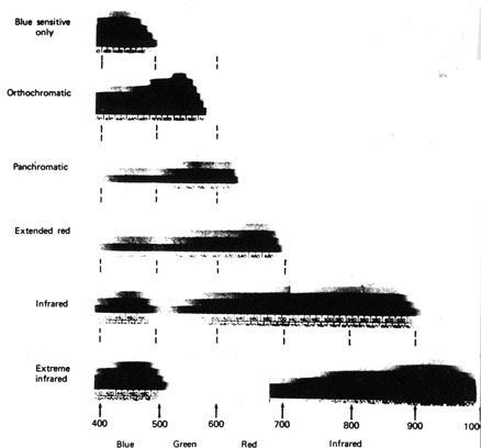

PE, do you mean that there are/were films sensitive to 1000nm? IIRC, thermal cameras see at that wavelength and above
There are infrared detectors that determine infrared beyond 0.9 microns [900 nm]. These can be in digital cameras, but I believe PE is referring to electro-optical equipment.
There were films that see to that wavelength and beyond.
See attached wedge spectrograms! The long IR film data is actually truncated due to the equpment itself. The film sees beyond that a bit.
PE
PE
Interesting! Have you got any idea about the expected life of such a film? How soon would it expire?

PE,
That there where at least plates sensitized up to 1100nm or so is no doubt about.
