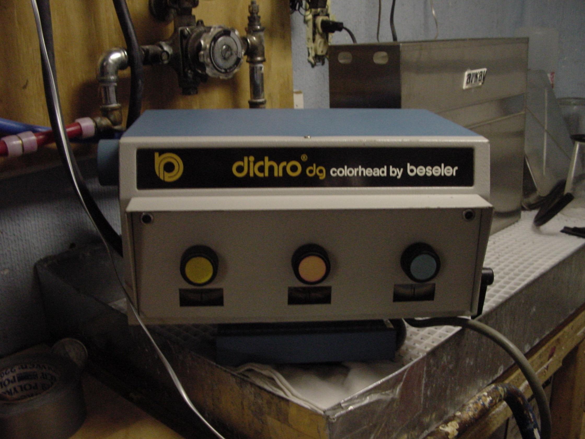

I have This head if your interested

I have one as well as a Dichro head like in the picture and by far I'd rather use the Dichro. The 45A is quite interesting technically and a brilliant concept but the unit seems way underpowered compared to what I can do with a Dichro.
I had a difficult time getting enough exposure to the paper to render the blacks, I mean the illumination level was probably equivalent to a 40 watt bulb. The Dichro has a couple of halogen bulbs, very bright but I don't remember offhand the wattage. My print times went from minutes to 20 to 40 seconds.
