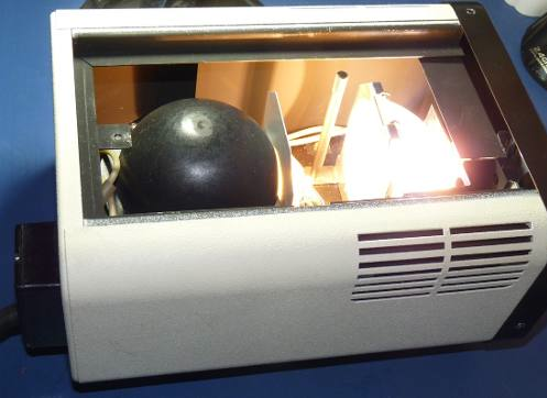

I really don't know... It looks like there is a diffuser:
But as I said.. removing the condenser makes the light uneven, with visible falloff from the centre.

I really don't know... It looks like there is a diffuser. Underneath the black sphere is a ground glass where the light comes from.

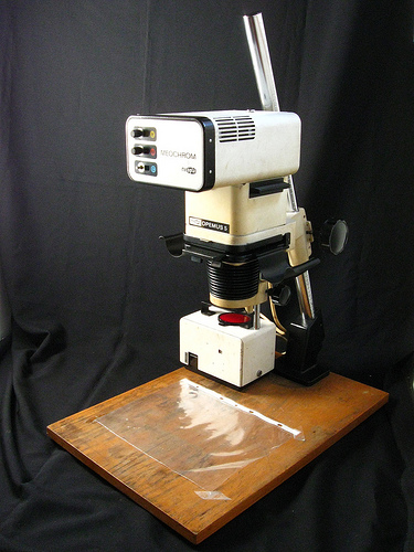

With meopta 5, you mount the color head in place of "normal" head, so everything else stays the same:

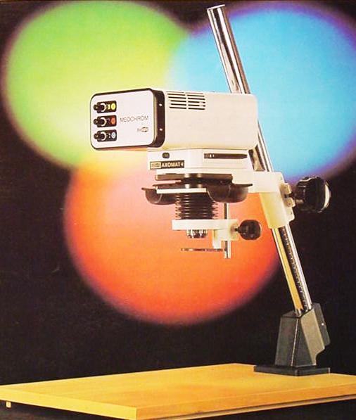

But look at this, it seems there's another model, Axomat 4, which is using the same color head, but is missing the whole middle part where condenser is:
1385412660_552017089_1-Fotos-de--Ampliadora-fotografica-Meopta-Axomat-4-blanco-y-negro-y-color.jpg
Makes life interesting doesn't it?
