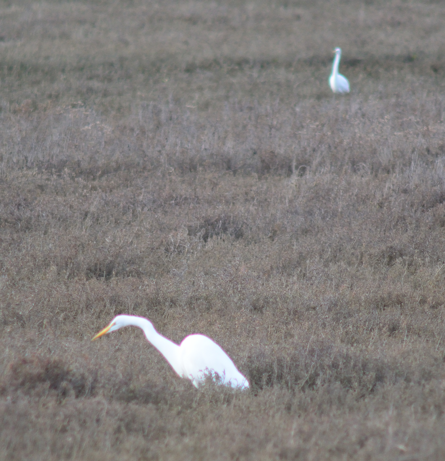

What cause this color fringing? How does one eliminate it?
Nikon D800, Nikkor 2x teleconverter TC201, Nikkor 300mmF4.5 AIS lens, ISO 1600, 1/500 at f9.5.
Lend data set in the camera per the manual. Not all images had this color fringing, just some of them.
Red fringe on the front Egret, Green on the rear Egret.
Crop:

It’s usually a lens aberration and it tends to appear in high-contrast areas more strongly in digital than on film.
Since you’re shooting digital, it’s correctable to a certain degree in Photoshop, and I presume other editing software. In CS5, I would open the image in ACR, select “lens corrections” and adjust for chromatic aberration.

I shot Sony A mount, I have a friends who shoot Nikon, I rarely have issues with color fringing, my friend has issues with older lens, might be the coating on older lens are an issue. I find this odd as I think the D800 uses a Sony sensor, if so must be in the firmware.

The extra glass of the teleconverter and the ISO boost doesn't help, but I know you have it that way for a reason.
Your whites are at clip or above, which exacerbates the issue of fringing. You might try shooting RAW with a modified profile that stretches the toe and rolls-off the highlights. Shoot with your whites well below clip and post process to bring out the shadow detail and differentiate your highlights.

It looks those fringes are from Secondary Chromatic Aberration, which tipically are green-magenta. ED glass was reportedly included in many Tele designs to remove that effect.

I’ve noticed it more with tele lenses than with shorter lenses in general, and yes, teleconverters will make it worse. More modern lenses should be better than older lenses, but I don’t do enough bird photography these days to justify the expense of testing that hypothesis. That Photoshop correction can make an older fast tele about $8000 better.

I shoot in RAW, convert to Tiff with Capture NX-D then use PS5 to do any further editing. The images that were tack sharp focus do not have the fringing. Those Great Egrets require a 2 stop under exposure to get detail in the feathers in bright sun. It was cloudy overcast and likely needed a 1/2 shot under exposure.

It's the lens/ teleconverter . This is why new professional 600mm lenses cost as much as a car. :smile:

The lens-teleconverter combo does not do it on my D300. It may be that extra 24 megapixels of the D800.:smile:
Shot some more today, fringing on over exposed areas and in motion blur areas. (Birds in flight)
Thanks for the tips.
I only get chromatic aberrations to that extent with older telephoto lenses, such as a Vivitar 300mm. Even modern kit zooms seem to keep chroma in check. Sharpening seems to exaggerate the effect, as will other sliders. Wildlife photography shows any weaknesses, with high contrast outlines exaggerating the effect. I only use those lenses for black and white work.

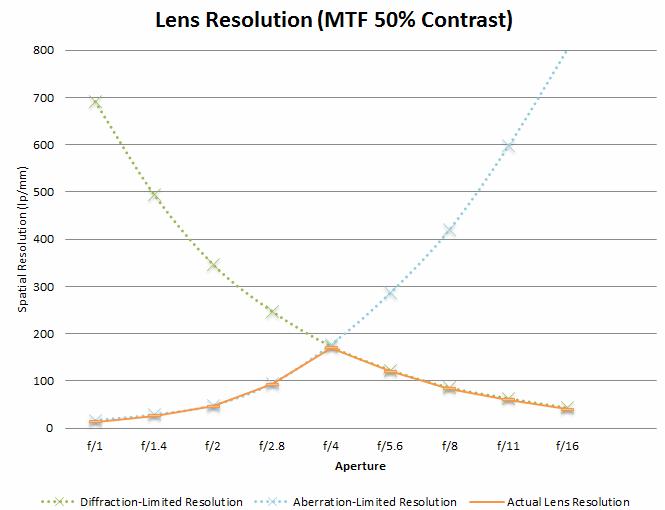

Yes, as we have to stop for DOF a cheap lens delivers mostly same result than a Pro expensive lens, as diffraction is the dominating effect while other aberrations are lower, this is an example:

color fringing is caused by what a lens does(refracting light).other than that, what Dave said.

Color fringing seems to be a worse problem for (some) digital sensors combined with (some) lenses. I believe it is a combination of lens chromatic aberration and the Bayer array - the fact that pixels on a digital sensor are arranged R G B G R G B G etc. The camera has to reinterpolate to derive the color image we see, and I think that when lens chromatic aberration interacts badly with that interpolation, color fringing is more obvious.
