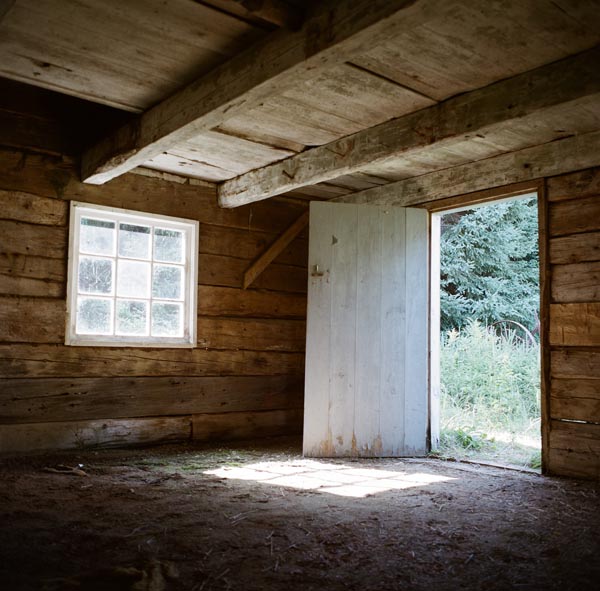

Try Portra 400NC, that's what it's made for:
attachment.php
This was taken with a Mamiya C330 w/ 55mm f/4.5 lens, in a logger's cabin, New Richmond (QC). Did I hear anybody say "dynamic range" ?
