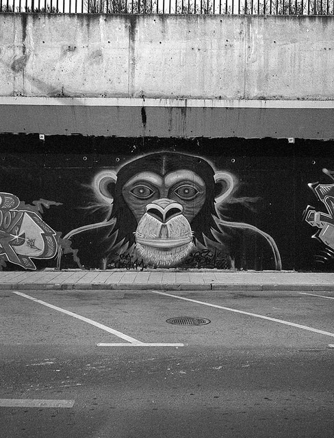

here are some examples of kodak 160 Vericolor developed with Rodinal stand development 1:100- ISO 100
there is no mystery to scan them the problem would be to enlarge print

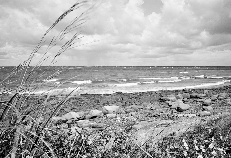

I stupidly made a mistake when putting two films into two tanks in one changing bag. The Ektar 100 ended up being developed in TMax developer. It came out like this:
Kind of a consolation prize, having it be respectable as a black and white photo.
