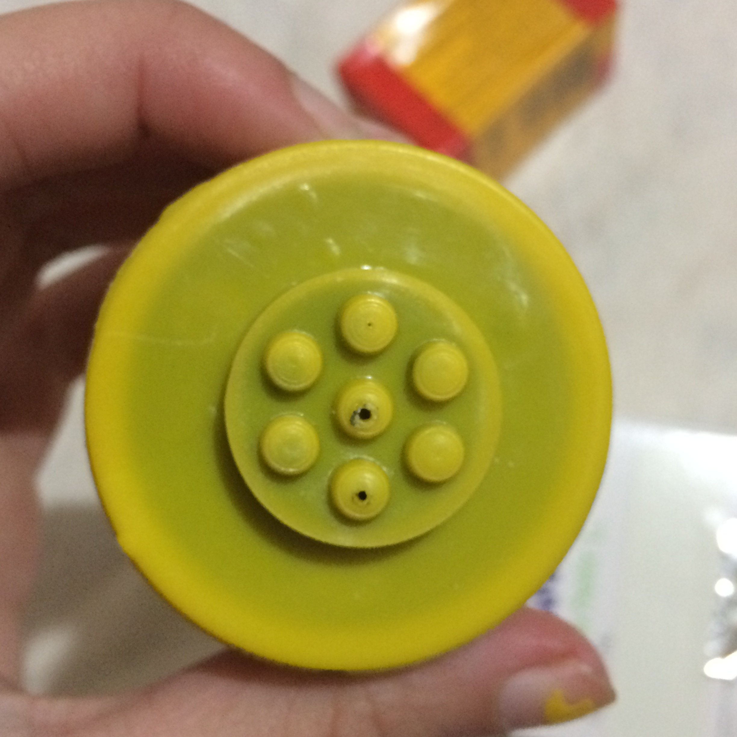

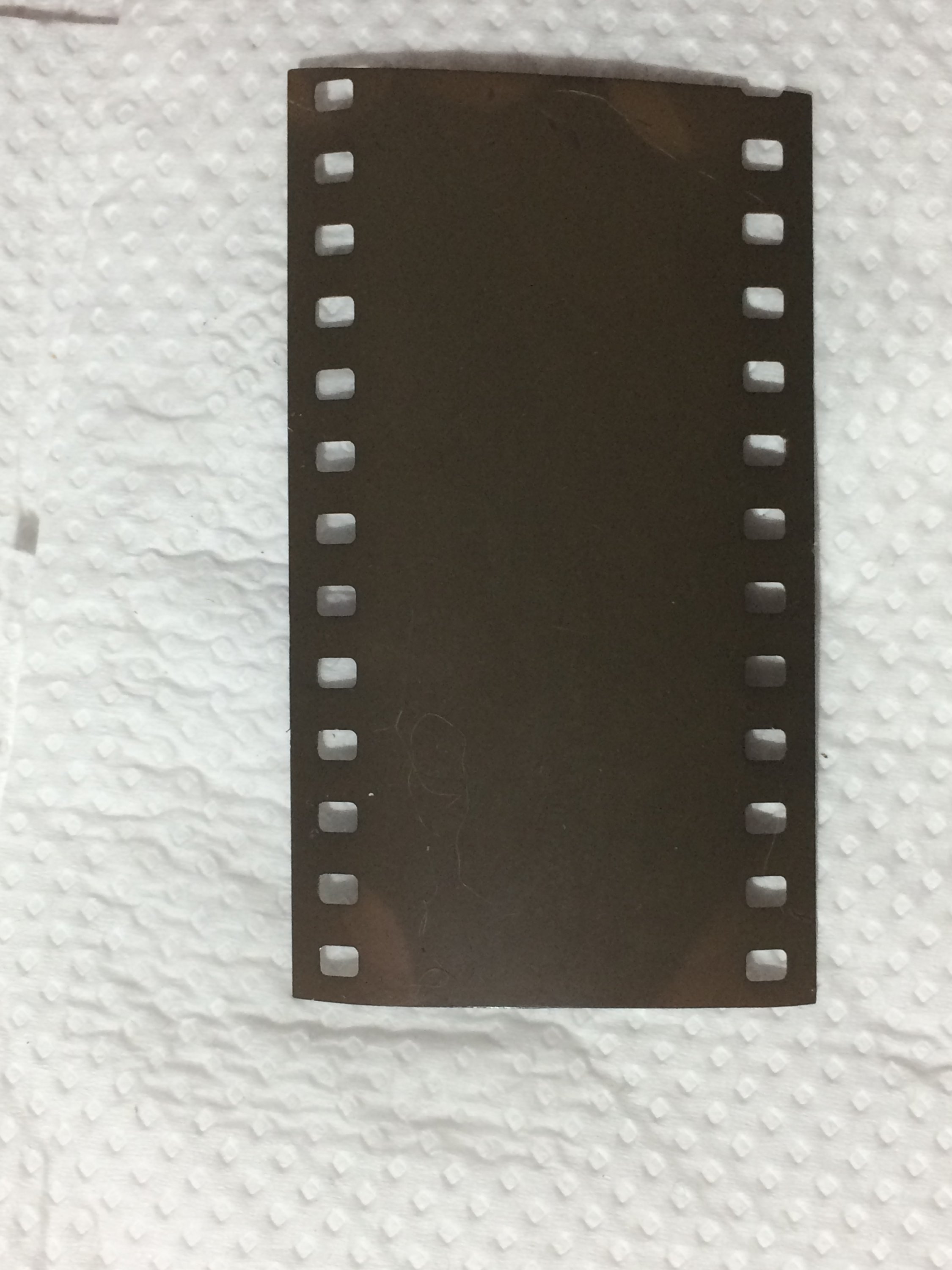

hello, i’ve never used pinhole or film before but i started reading about it and got really excited to try. so i made 3 pinholes and kind of guessed the size of the hole and took some pictures. i developed and fixed them at home with that method of coffee, washing soda and vitamin c and for the fixer water and salt but they all came out black. i guessed that i overexposured them because i left for a couple of minutes and it was really sunny. just one of them had leaf “marks” on both sides and the rest was black. so i tried a couple more leaving them for just a few seconds and they all turned out black too, one of them kind of white which i think it means it didn’t get the exposure necessary. i tried to do like a lumen print by putting a coin on a piece of film and then developing but i just got a little spot on the side, like a little blob. i don’t know if the problem is on the film, or this developing method (the pictures look brown like sepiaish but there’s nothing in them) or it’s the size of the hole or something else. does anyone know or have some ideas/thoughts about what i’m doing wrong? thank u!

Pinhole size? You would be surprised at the sizes of pinholes. You're looking at diameters of thousandths of an inch, barely a pinprick.

@flaviarosa Most pinhole cameras use a hole between about .25 and .5 mm (.010 to .020 inches). If yours is, say, a full millimeter across (and it might be larger, if you used a map tack and shoved it all the way through your material), and you're using modern ISO 100 to 400 film, your daylight exposure might be as little as a single second.
Making lumen prints with film, on the other hand, has typical exposure times of hours to days, even in direct sunlight. Photographic paper actually prints out faster than film does; you can get a lumen print in a matter of an hour or so.
Also, your fixer is probably not actually fixing your film. I've read many times about using salt water as fixer, but all it'll do is convert silver bromide and iodide in the film (very slowly) to silver chloride -- you'd still have to give the film a bath in clear houshold ammonia to dissolve the resulting silver chloride.

Just for clarification here , flaviarosa, is this a colour film you exposed but decided to develop it with a B&W developer? You thread says Color film

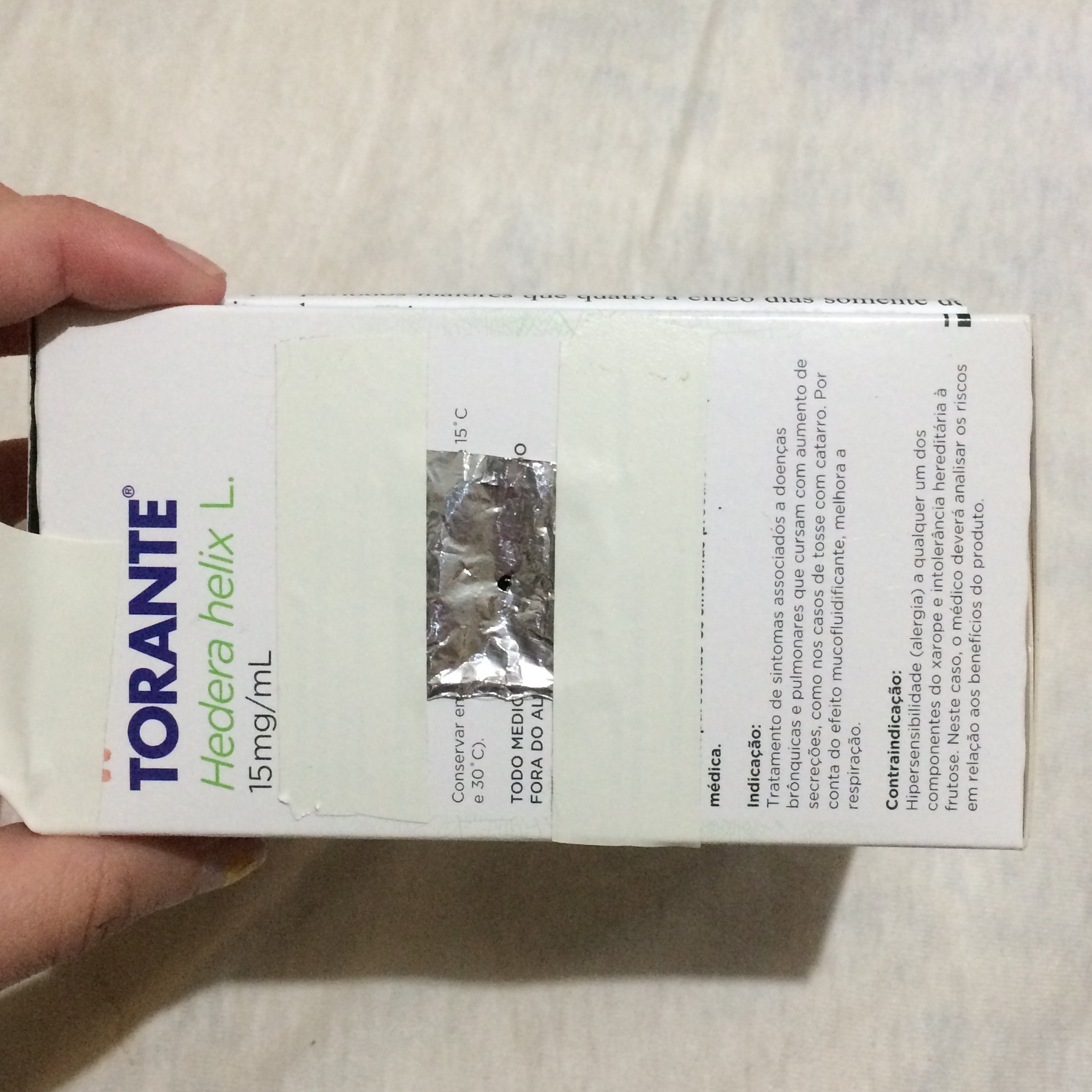

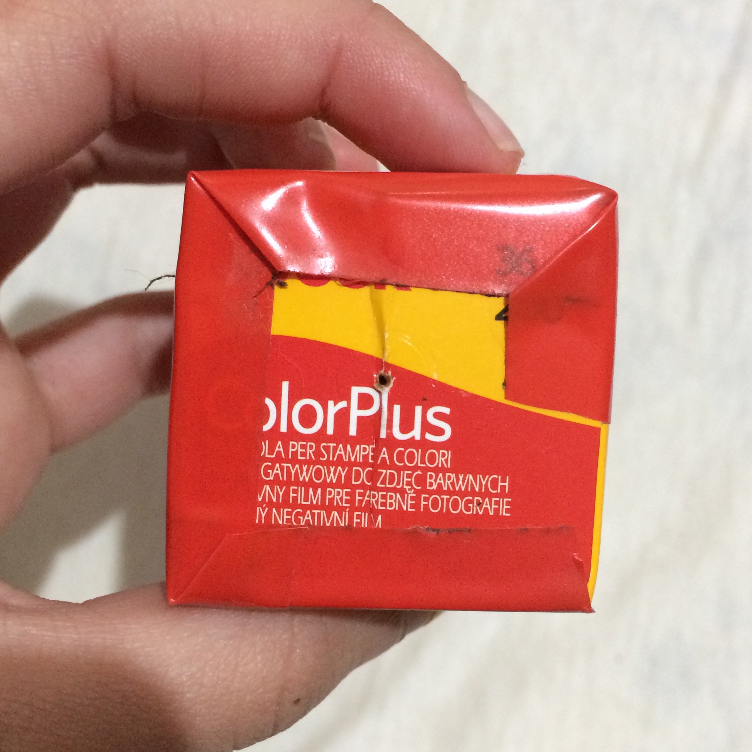

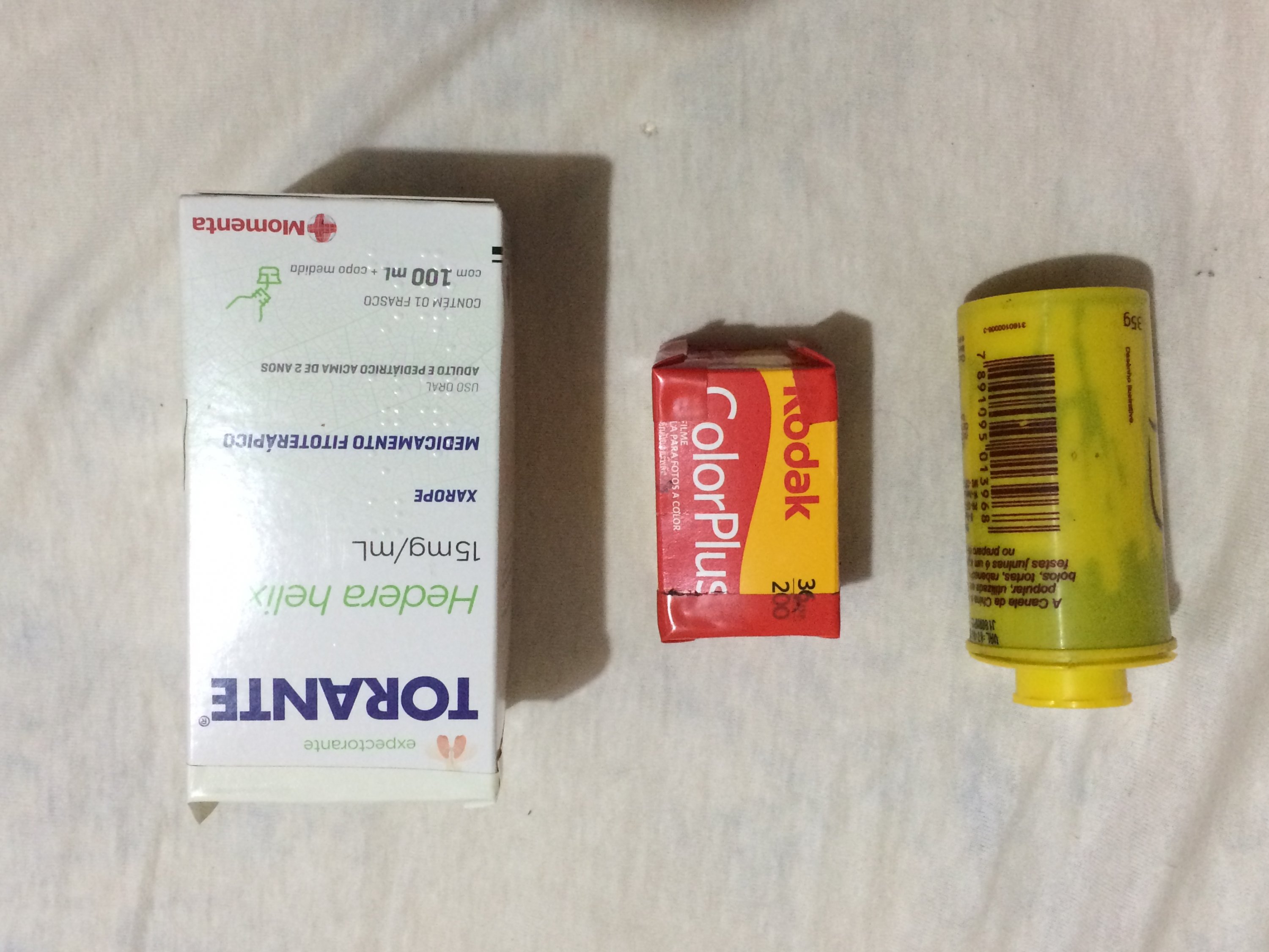

they are all different sizes actually. i guess i got too caught up researching historic context, contemporary uses etc for the text i had to write that i didn’t pay the attention needed to how to properly execute

yes! i was way off leaving it out for so long (i’m using iso 200) but today i tried leaving for not more than 2 seconds and it ended up the same, they look lighter but still nothing in them.
oh, i see. i wanted to get photographic paper originally but it costs like 230 + shipping where i live and i dont have that kind of budget. i also read someplace that film was more sensitive than photo paper so that’s way i didn’t leave for that much time.
i get what you’re saying about the fixer, thank you for telling me but i don’t think that’s the only problem. at least on the videos i saw even when developing in the darkroom you could see that something changed but not on mine

unfortunately yes, pentaxuser, that’s what i did. like i said i don’t have any experience with film and not very much money, i couldn’t find a homemade version of developing color film and didn’t get any answer back if would work so i decided to try it anyway

I'm guessing that your film is being exposed to too much light in general - either from leaking light, or exposure that is too long and too intense.

If you have anything close to the correct exposure, you should at least see a developed image even on color film processed in Caffenol. If not properly fixed, the film may darken over time and exposure to light, but as others have suggested, those containers don't look light tight (and yes, those pinholes are larger than optimal, though they should still produce images with the right exposure).

Those containers look like they’re not even close to opaque enough. I’m guess light is getting transmitted through the box. Also, those pinholes do look a little big.
i painted the inside of the boxes black (opaque paint) for that, and sealed the sides, do i have to paint/put black tape or paper on the outside too?

that's what i don't get, why i couldn't get anything on any of them even even when exposing just from one sec. even though i painted the inside of the boxes black, there could be some light coming through one the sides but with the round yellow one, there's no way that's the problem because itself is totally sealed (as much as the pinhole is bigger than it should). i even saw a tutorial for a matchbox one like you're saying but i don't have another film cassette and because i'm in my hometown right now, i don't think there's any photo labs here. anyway, thank you very much for your help, i'll research more, try to make new (and proper functional, i hope) ones and pay more attention in doing so.

Part of your problem might stem from the pinholes being too big. I'm guessing that if you're buying your film at the local shop, it's going to be ISO 400 speed -- almost all consumer 35 mm film is these days. If your pinhole is too big, it may not be practical to make exposures short enough. If you can make your hole smaller, around .25 mm for the size of those cameras, you should get bright sun exposures of two or three seconds instead of being overexposed after one second. Once you can manage that, you should be able to get images you can actually see with Caffenol.
Now, if you have a place around that sells supplies for swimming pools or spas, they'll have sodium thiosulfate as a chlorine reducer. You can use that to make real fixer (60 grams per liter works well in my experience, though for color film, you'll want to fix three minutes, and then fix another three minutes in a second, fresh bath to get full fixing). That will work much better than salt water.
