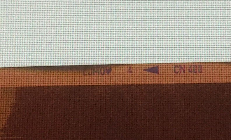

so now the Redscale has become a regular colour film, but I have no idea what manufacturer and model. Lomography do use these days some Fuji, the negatives have CN-100, CN-400 markings.

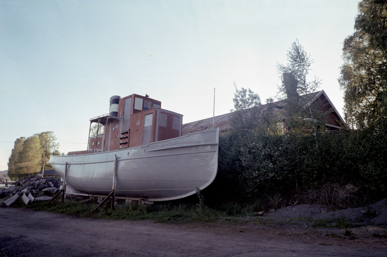

i grabbed the Horseman with a 6x9 back and shot at iso 100.
developed in freshly mixed C41 dev. Unfortunately I had a small accidental contamination in the water I used for washing after the dev and before the bleach (i do dev-bleach-fix, not dev-blix), it shows most in the last of the pictures loaded here.

interesting, I will shoot other rolls at iso 200 or 400 and see, instead of the iso 100 used there. I developed two rolls of Lomography-400 last week but I think they were couple years old, and had the CN-400 coding, so I believed it was a Fuji:
not so important, can be of practical use when saving inversion settings for further processings.

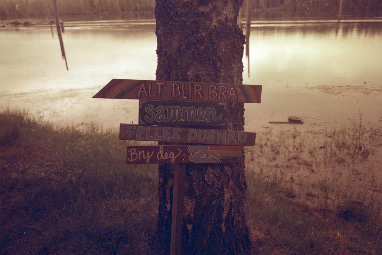

the other day I did shoot my first roll at iso 50 , as I wanted to avoid harsh red, two first pictures here were under cloudysky, last one under much brighter sky. Not sure what for I would use that film, I tried diverse modifications of curves, colour balance, etc, but I think I need to shoot a lot of it in order to know what kind of picture I will get, what tweaks are possible in post-proc.
so instead I decided to unwind and rewind on its other "correct" side, the next roll
