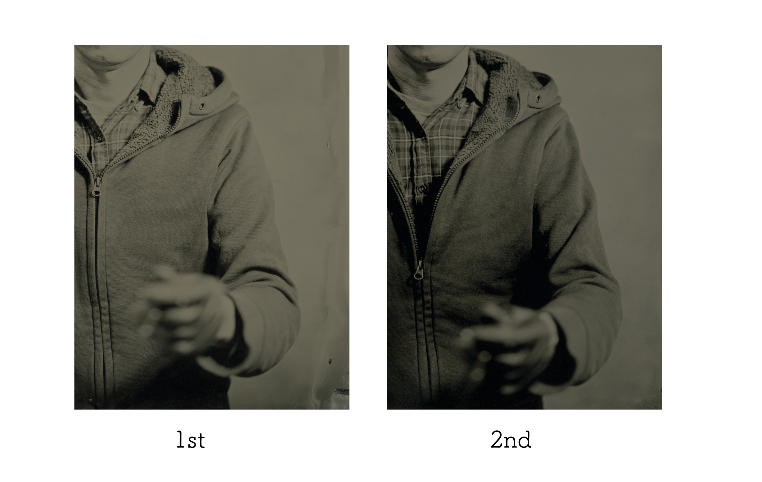

The two images attached were taken with the same strobe intensity and developed within a 30-minute span. There is a noticeable difference in sensitivity, about half, and I'm wondering if this is due to differences in the thickness of the collodion. I'm using the same collodion and silver nitrate for both. The hypothesis is that higher collodion density contains more silver halides, making it appear brighter while the sensitivity remains the same. Do I understand you correctly?
Yes, you do. It's at least the hypothesis I based on your own suspicion that the thickness of your collodion might vary from plate to plate:
The thickness of the collodion seems to vary.
So that's the hint I went by. It's not the only possible hypothesis, however. As hinted at earlier, other factors also play a role in silver halide content.
And then there's also the issue of development, which can sometimes be hard to get consistent from plate to plate (although you seem like a well-trained and consistent worker to me).
