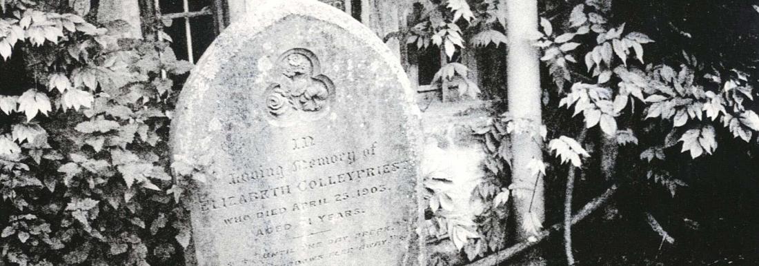

Sorry, didn't mean to overstep then. Forgot to specify it was the MG paper. Haven't used any of their other papers. I never read your post properly Mark. That snowy print looks really nice. I'll have to try some of that Foma variant 111 some time. How does it respond to gold toning? I want something that goes as blue as Fotospeed. The MG doesn't look so perdy in gold toner. Did you get my message about scanning prints?
mrtoml
Sep 28, 2005
566
Sheffield, UK
Sorry, didn't mean to overstep then. Forgot to specify it was the MG paper. Haven't used any of their other papers. That snowy print looks really nice Mark. I'll have to try some of that Foma variant some time. How does it respond to gold toning? I want something that goes as blue as Fotospeed. The MG doesn't look so perdy in gold toner. Did you get my message about scanning prints?
No problem. I was just clarifying as the OP is in Australia. It would be pretty annoying to order some foma paper assuming it had a warm base and then finding it is white after the huge postal charges :smile:
I don't do a lot of gold toning, but the only swatch I have of foma variant 111 in gold is a very subtle effect. Just slightly blue (see attachment). I have much stronger blue with other papers in my files:
E.g., Adox fineprint:
http://www.flickr.com/photos/alt-digital/2982126154/
I also get a nice deepish blue with Fomatone MG, fotospeed lith and Kentona. I use Fotospeed AU20 toner and there isn't a lot of difference between them.
