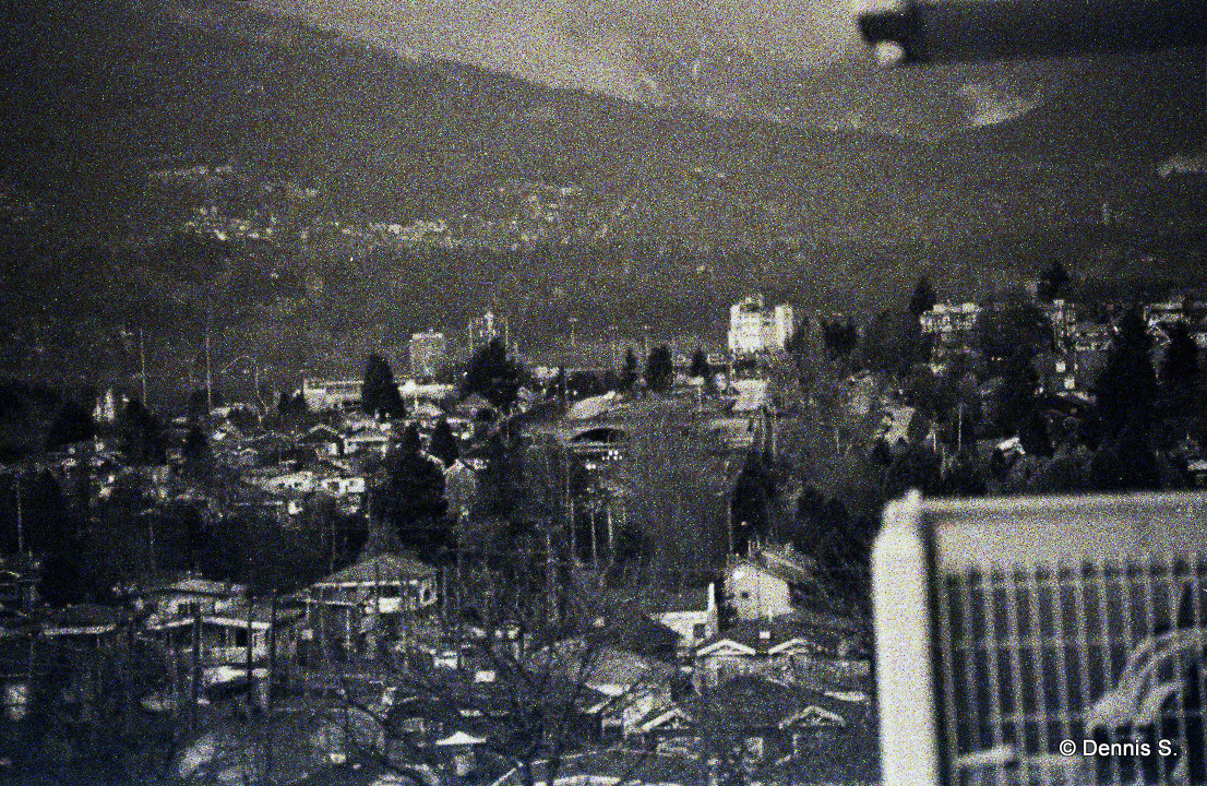

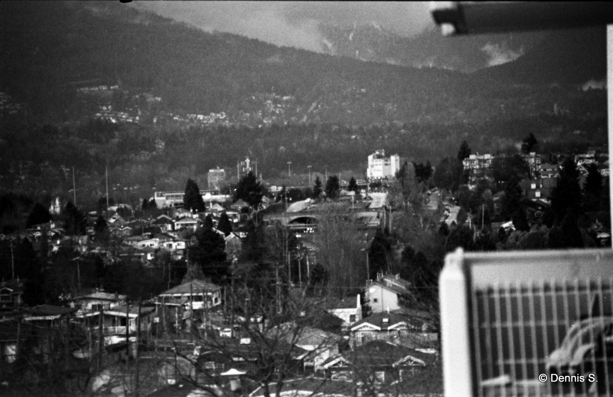

Fuji Superia 200 in Caffenol C 30 min
1-Caffenol C 30 min  020.jpg 1-Caffenol C 30 min  021.jpg View attachment 90726

That's a helluvalotta scanner noise in there too. Was it particularly dense (or thin)?
Just curious as to how the base of Caffenol-devved films comes up (either B+W or colour stock)? Is it anything strongly-coloured that might interfere with Multigrade papers?

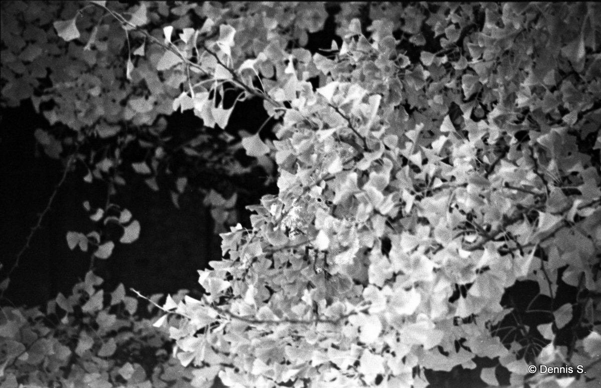

I have used coffee for paper developing as well with some good results. The first was regular Arista paper. The next was a Foma warmtoned paper with very surprising result. Used same negative on both
A foggy  night shot. (coffee dev.)_edited.jpg Same as previous only on warm tone paper.jpg
