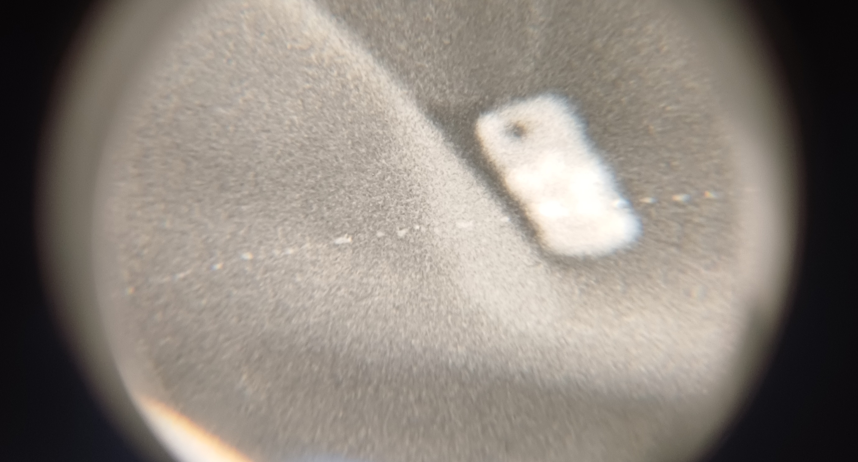

Notice that about 1/4 of the bottom, there is a faint line of tiny "white" spots visible, almost the entire length of the print. They are about 0.1-0.3mm in size, spaced (less than) one to a few millimeters max apart.
In fact, when looking through a 10x loupe, see one of the images below, it becomes clear these spots aren't in fact entirely white, but light grey with still visible grains, as if the second high contrast coating layer of the multigrade paper had these defects, but not the low contrast one. My first line of thought was a scratch (before looking through a loupe). But a scratch on the negative's emulsion should result in black, not white spots. Inspecting the negative on a light table using a loupe, also doesn't reveal an obvious issue, the negative looks fine without any spots, whether dark or light. And as for a scratch of the paper's emulsion through careless handling by me: there appears to be no visible scratch to the glossy surface when I bend the paper in strong light. Of course, with the emulsion of the paper being scratched, I would also expect the dots to be more or less completely white, instead of greyish. I have seen a few more prints with this type of "scratch" while using the same package, while other prints appear to be fine.

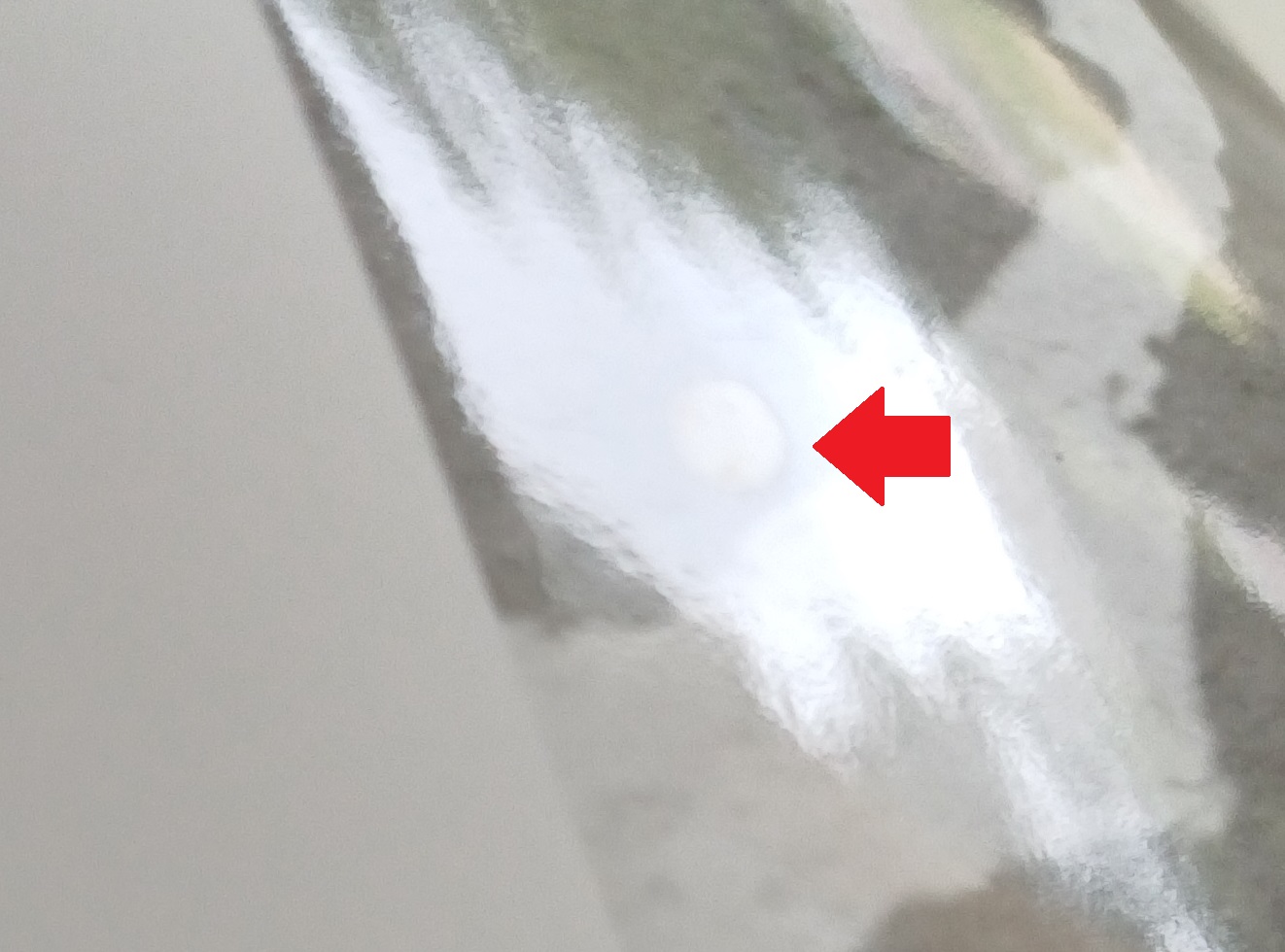

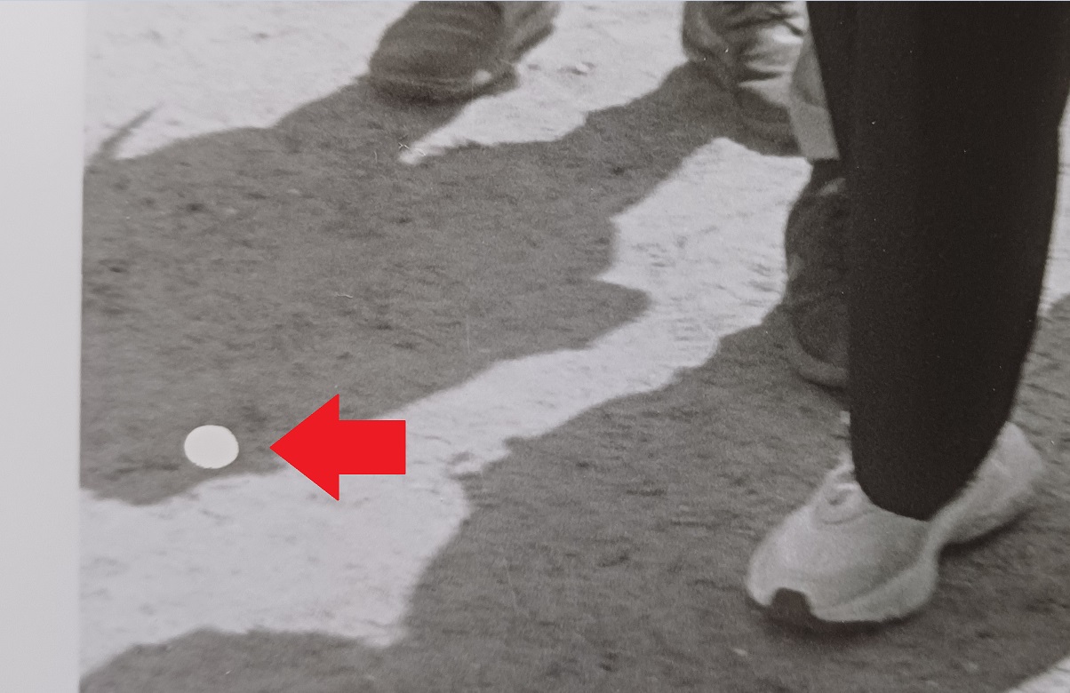

I also had a clear issue with one other print, see below, where there appears a large (about 0.5cm diameter) bright white "hole" in the print. Looking at an angle to strong light, there appears to be a clear "ridge" in the emulsion causing a tiny shadow to the right of the hole, as if an air bubble prevented the coating from sticking to the paper at that point. A second print of the same negative on a new sheet of paper was fine.

It's much more likely that some tiny spots of (dilute) fixer on you, your clothing or the general environment got on the paper. It doesn't need to be working strength to have the effect seen.

Ok, thanks for the analysis so far. I still have a hard time explaining the large white spot though, given my general workflow, but it most likely is then though no development, as I can't see a fixer stain getting such a clear perfect border.

As to the dotted-line defect: it doesn't look like a coating issue to me. Coating issues of repeating nature more likely occur in straight lines. They tend to not wander about erratically. The first thing that comes to mind is a trail of calcium drying spots left by a droplet of water finding its way down the length of the film as it dried.
I don't know what the big spot is. It's conceivable that you're contending with an air bubble that didn't dislodge due to your very minimal agitation routine. You might try a more conventional approach to print development.

As to calcareous deposit: final rinse is always with demineralized water and wetting agent. It is not a 100% garantuee for no problems, but I haven't seen much of issues in this respect after I switched to using demineralized water instead of just tap water with wetting agent, which definetely did leave ocassional marks of deposit.
Honestly, the agitation isn't that "minimal". It is fairly rigorous, but an air bubbel might still be at least one viable explanation.
