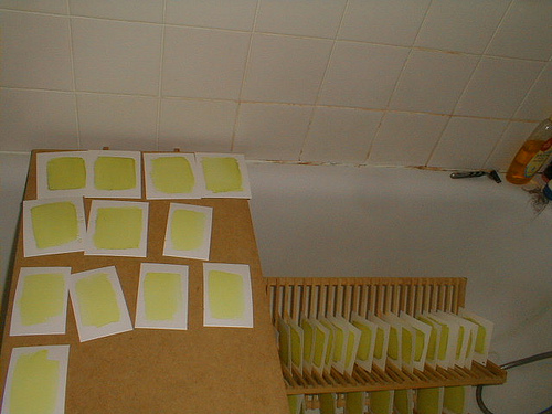

It will be sort of yellow with a tiny tint of green when it goes on, it'll dry a bit darker green. Yes all the coating will come off if you've not exposed the sheet.
What's going on is that cyanotypes like acidic paper which is a bit harder to find in nice papers these days because archival means basic environment for everything else but cyanotypes. The solution will react with a very alkaline/basic material and will start to change colour without any UV light hitting it. Normally when this happens, the paper will be pretty blue rather than green.
I've found normal paper for printers (not the fancy kinds) tends to give a mottled result with not very dark blues and generally not nice looking.
Below is a picture of what colour you should be aiming for when the paper is coated, maybe a little damp but it will dry a tiny bit darker than this colour in my experience.
